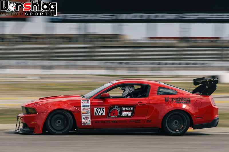

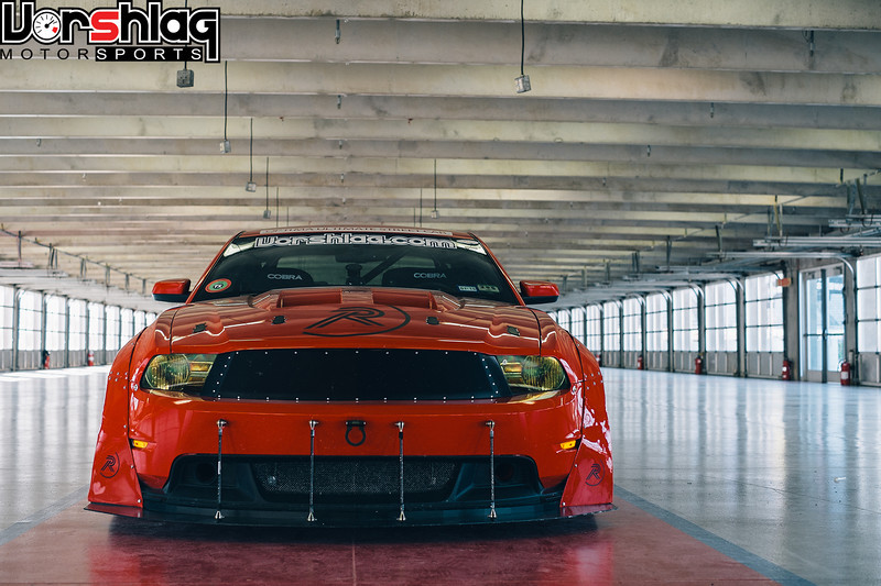

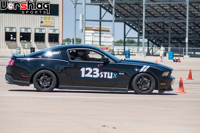

Well, I get that it looks pretty racey, and we have done a few "big things" to our Mustang (namely - aero) that are tailored for another series (NASA Time Trial), but those have almost zero affect on autocross competitiveness. The numbered NASA TT classes have very few restrictions, but even still we've left a LOT of things off of our car that could make it faster in that series.
But when it comes to autocross-worthy mods, we haven't done many of the things that are still allowed in ESP or Street Mod classes. We still have the full weight interior, air bags, A/C, radio, and more - all of which could come out for ESP/SM. Many ESP prepped cars at Nationals in 2012 were far more prepped than we were. Heck I was still on soft springs (450 then vs 800 now) and skinny tires back then (315s).

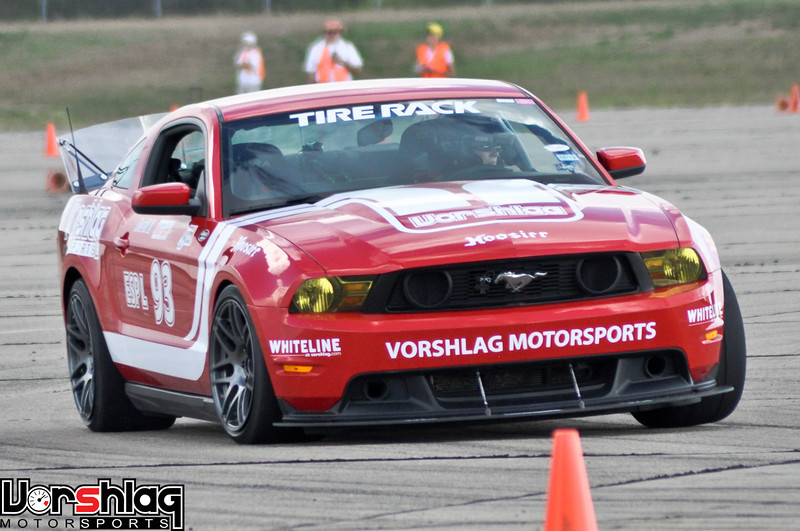

Our Mustang at the 2012 Solo Nationals, above. 18x11/18x12 wheels and 315mm Hoosiers under stock fenders. It wasn't well developed for ESP

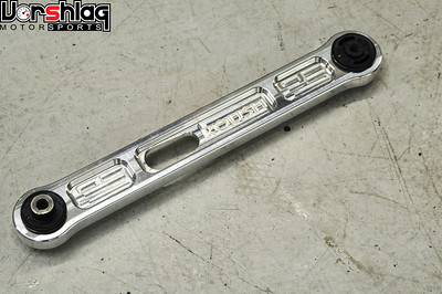

Even now, we really only have some of the common legal suspension and tire mods for ESP. Good shocks/springs/camber plates, swaybars, LCA brackets (not ESP legal), rear UCA and LCA arms (not ESP legal), front LCA bushings, a streetable Watts Link, and that's it. The Torsen T2-R we have was a nice upgrade but we didn't have that, or half of these suspension mods, back when we were in ESP. There's no magic or custom parts there - all of these are off-the-shelf pieces anyone can buy. We could have custom torque arm (the only time I'd add one of these to an S197 is to get around weird rules restrictions for autocrossing), 200+ pounds of street worthy parts would be removed, we would run a lighter transmission, a Boss 302 motor, and a lot of parts from another S197 Mustang that will go unnamed. It would be a LOT more radical than it is now, and not street legal.
The front and rear flares plus the aero we added for NASA TT3 use allow for more tire clearance, and the 18x12" wheels we run and 345mm rear tires are a little wider than we had before - but are all ESP legal. The aero works at higher speeds but is worthless in a parking lot. We ran 18x11 front and 18x12 rears before under stock fenders, but in ESP you can cut and hack the fenders more than we have, and you don't even have to run flares. Heck, the tires can poke out the fenders by a mile...

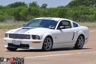

This 2006 Mustang beat us in ESP. It had 1000# springs, 335 tires, 100 less hp, no A/C or emissions, and was much lighter

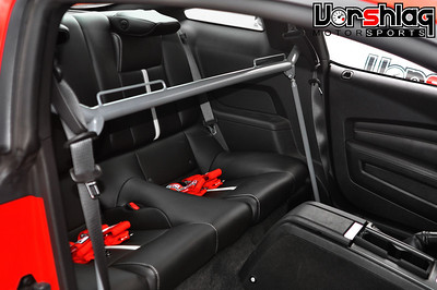

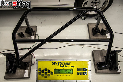

What else have we done to our Mustang? Seats/roll bar/harnesses, but again, that was mostly for track safety. I wouldn't waste 63 pounds on a roll bar for an autocross car. Nor would I use the big rear wing, ducted hood or splitter - which itself catches cones regularly. ESP only allows for 1960s aero mods, like the rear spoiler we used to run. A splitter has almost no affect at autocross speeds.
So while it looks like we've done a ton of mods, anyone could replicate the ones relating to autocrossing for not a huge sum of money. I think we could keep it around $10K in parts, that matter for autocross? We actually have NOT installed a lot of "popular" suspension mods we see on daily driven and track prepped S197s all the time. Why? Because we don't feel they make any real difference, and are just "wallet lightening" mods. Things like bump steer correction kits, all of the bolt-on braces, sphericals in every bushing, tubular front crossmembers and control arms, a torque arm, SLA front suspension, 2-piece rotors, and on and on and on.

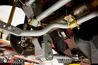

With a few rear suspension allowances (left) and a bump up to 315mm tires (right) this car might have a chance in STU
Just to set the record straight...it had 335's on the back only because Goodyear didn't show up with our tires and Hoosier only had 2 315's. The only had 2 335's as well, so we had to jump on those. Not ideal, but they were good.
The car had full emissions. Stock Intake Manifold, Stock Exhaust Manifold, OEM Cats. Had a Magnaflow CatBack, a CAI & a 93 octane tune. No idea what it had at the wheels, but somewhere under 300.

Another letter campaign to the SEB on more allowances to STU for Mustangs?
-Solid axle cars are allowed up to 305mm tires (I figure this might sound better than 315's)
-Allow replacement of all rear suspension links (allow adjustable, no full spherical)
-Allow adjustment of rear suspension link attachment point(s) via factory backed aftermarket (FRPP, GM Performance, etc.) means or the use of parts similar in design/function to those factory backed aftermarket parts (maybe just start with simply and only factory backed aftermemarket means?)

Holy Moly! All of our work has paid off. I have to give a tip of the hat to anyone on the forum that wrote letters and urged the SCCA SEB to give stick-axle cars more allowances. The new Fastrack is coming out and it's got two new proposals that allow relocation of axle side pickup points and replacement lower arms for solid axle cars in Street Touring and Street Prepared classes.
-BUT-
This is just a proposal! You, yes YOU, have to write in to the SEB in support of these proposals if you want them to go through.
Send those comments to www.sebscca.com
Here's the text from the new Fastrack, located here, http://scca.cdn.racersites.com/prod/assets/solo.pdf:
Change Proposals
Street Touring
#12063 Solid Drive Axle Allowances
Replace 14.8.G.5 with the following:
“The lower arms may be replaced or modified and the lower pickup points on the rear axle housing may be relocated.”
Street Prepared
#14101 Solid Drive Axle Allowances
Replace 15.8.I.5 with the following:
