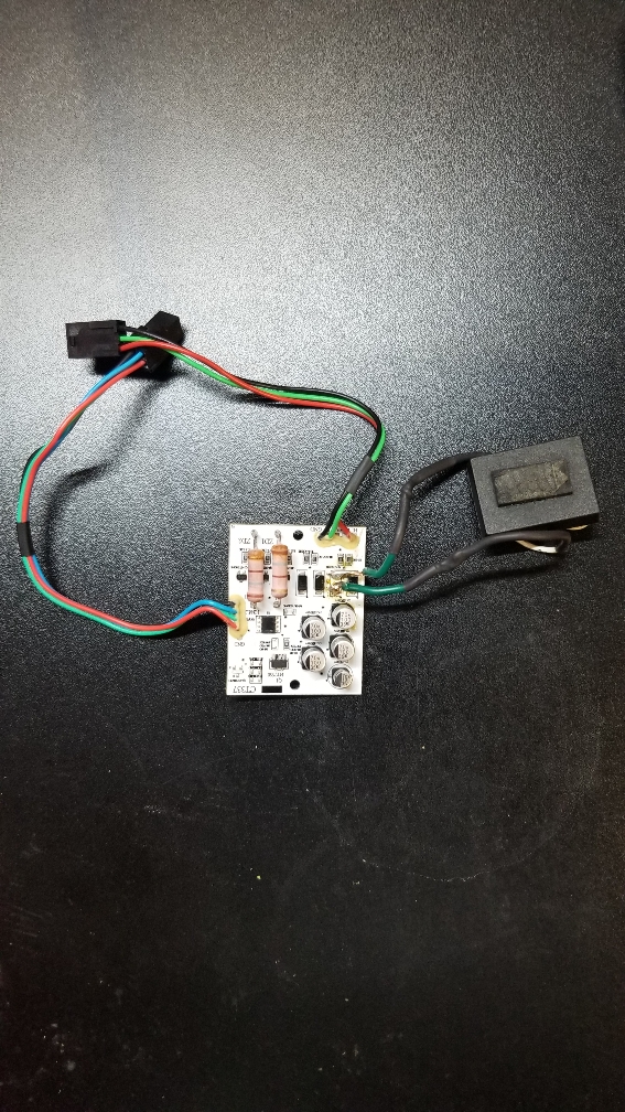

I had a set on my S197, they have a flaw with an under current rated Diode that gets fried. I work in EE and found a better diode from DigiKey and fixed both of mine, and another set. Had to buy a reel of 50 diodes. If you wanna send me your broken one I'll fix it with fresh diodes.

Two load resistors got some heat but its the far right Zenor diode, near the Helen Keller solder job I saw when I first opened it up. Easy fix with the right parts.

LOL well that's the designation for an axial thru-hole diode. Do a little research on SMC and footprints. I haven't seen through-hole diodes used in a long time. These are 4 layer boards with 2 signal planes.
You also do not want to increase the current limit, rather increase the time the diode can sustain that current. Stock SurgeC appeared to be around 8ms, I upped to 30ms. Also PowerD from 1 to 3
DO-214AC package, SMA footprint. :)

The reason why this forum has lasted as long as it has (and, let's be honest, it's well beyond its usefulness, like so many Stang/motorcycle other forums I still belong to) is due to people like Rick, macman45. While other social media sites, like FB, can be effective, they'll never match sites like these, where members hang on for years, decades even, sharing info and helping each other out. Rick is one of those guys. Matter of fact, I sold Rick a pair of OE Bullitt mufflers a couple years so we had 'history.'
Out of the graciousness of his own heart, he reached out to me privately and offered to use his knowledge, technical expertise and skills to fix my tail lights. He didn't ask for anything other than to pay the shipping costs, which, of course, I did w/out hesitation.
I shipped him the lights and he returned them in under a week. He found a number of issues, fixed them all, and the lights work perfectly again. I've thanked him repeatedly in private fashion but let me do so in public fashion- THANK YOU, Ricky. You saved me a lot of $$ from buying a new set of lights.
