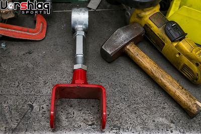

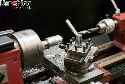

Damned Upper Control Arm Set-up, Test 4
So we've put 4 or 5 iterations of Rear Upper Control Arms (UCA) in this car and have been happy with none of them. No matter what brand or style we try it always eventually comes loose, then clanks and bangs around on any bump. Very frustrating. The various designs have also taken their toll on the axle-side UCA bushing, that is press-fit into the axle. Our techs noticed that this rubber OEM bushing was cracked and completely shot, so while the axle was being refurb'd they pressed it out and in went a fresh new one. Why not poly, you ask? Well this is one of those "terrible places for a poly bushing"... as it needs to both rotate and twist in 2 axis. Polyurethane rarely has the material properties for this task - it should be rubber or a spherical bushing.
After a quick glance we couldn't find a spherical set-up for the axle-side bushing (yet) so we just went back with the OEM rubber to replace the cracked and failed unit, for now. If you have an aftermarket UCA, especially if it is a poly bushing on the chassis side, check out the OEM rubber bushing in the axle at the top to see if it has cracked and failed. Click the high rez versions of the above two pics to see what to look for.
With that axle-side bushing replaced I wanted to look at the UCA itself. The Whiteline unit was fine but the adjustment method was a bit unusual and it wasn't exactly silent in use. Everything else they make for this car has been perfect, but I dunno.... I really wanted to keep the bushings able to rotate freely on the UCA, as both of these joints need to pivot smoothly when the car is loaded in corners. At first I wanted to attempt to go back to the "Del-sphere" bushed, adjustable length UCA we tried earlier from Spohn. That thing had some of the worst clanking and banging of any UCA we had tried but it did have the right style bushing at the foreward UCA mount... a Delrin-encased metal spehercial end, called "Del-Sphere". This is the right type of joint, I just didn't agree with the execution of the entire arm and mount.
We thought the problem was with the over-sized bushings that came in the Spohn UCA kit. The kit is made to work with the factory UCA bolt, which is a 14mm OD bolt. The ID of the Del-Spehre end is much larger, as were the holes in the UPR fabricated upper mount. It was as if these companies made something without checking the factory bolt diameter. What the...? So we upped the size of the UCA bolt to a 5/8" and made bushings to fit snug around the OD of the bolt and inside the ID of the Del-Sphere bushing. It took a little time on the lathe, some careful drilling, and some drilling of the UCA mount, but it all goes in and out smoothly now. No more slop to the bolt and hopefully no more banging around.
Well, of course I cannot find a picture of this newly configured UCA and joint set-up actually installed. Oh well, will shoot it next time the car is in the air (this Friday). And driving it... well, it is a little quieter now but is far from "noise-free". We checked it after the NASA event and it was all still tight, so at least this isn't getting loose and slipping every time it is inspected. We will keep trying to come up with a proper UCA solution using aftermarket parts or we will have to make something on our own. We purchased a complete Boss 302-S UCA set-up last week and will try that next, in either the 2011 GT or the 2013 GT.
