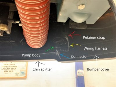

Update: Got the new pump and once we got the car up in the air, we discovered that the connector on the old intercooler pump was damaged, probably from a curb stop/speed bump/rumble strip. For any Saleen Series VI SC owners that aren't aware of the install conditions, please see the pic below of the new pump install and the relation to bumper clearance. This location is precisely as described in the Series VI SC install instructions. The view shown is looking frontward with the rear of the car behind the photog. As you can see the new connector is actually below the plane of the front bumper cover and very easily susceptible to damage. Track efforts with a lowered vehicle, as this car is, can translate into a sheared connector or damaged pump pretty easily. Our tech foisted the new pump upward in the install bracket as far as possible but only gained about 1/4 inch at best. If you believe you are running high SC coolant temps, this place may be a good place to look first.
