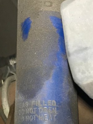

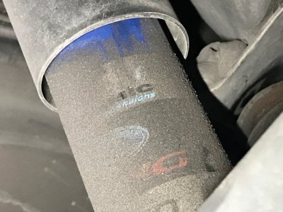

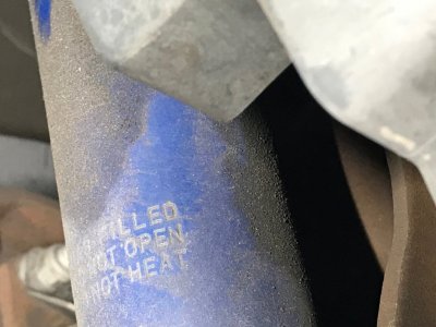

I need a little help peeps. I've got Ford Preformance adjustable shock/struts and I found a rear shock leaking. Here's my problem these only come in complete strut/shock sets I can't find just the rear shocks alone anywhere. So I need some recommendations on what rear shocks to pair with my Ford Preformance struts? IMG_1935.jpg IMG_1936.jpg IMG_1937.jpg IMG_1936.jpg IMG_1937.jpg

Koni have been the preferred brand on the S197 platform since they came out. Orange are non adjustable and slightly cheaper, yellow for adjustable damping. I had yellow but ended up leaving them at the softest setting all the time.

skwerl Thanks for the reply so tell me is the orange and yellow the same as far as ride ?

I never owned the orange but have read multiple times they are the same as the yellow ones on the softest setting. I'm sure Google can help you find the correct specs on Koni's website.

For a non adjustable I would go with the pricey Bilsteins. They are actually variable dampening and adjust well to different conditions. I loved them on my car. Ran them with Eibach and Cobra Jet springs.
As far as adjustable I like the Viking Performance dbl adj ones. They haven't been around that long but have a great rep. I'm putting them on my 2nd gen F-body build as we speak. They are the preferred shock with BMR also.
For the Strip I usually end up going with my fall back Lakewoods.

Koni oranges will leak after a few months, they suck. Id rock Viking double adjustables.
