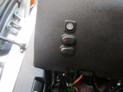

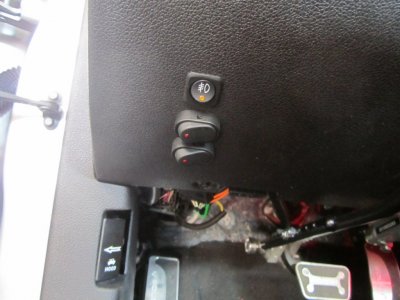

I never realized that dash was all one piece, though for sure that knee panel was a separate piece. In my 2018 it is a separate piece and has an airbag in it, had to be removed when I had my hand controls installed. My 2010 they were able to cut a slot in the panel for the hand control linkage, 2018 panel had to be removed.

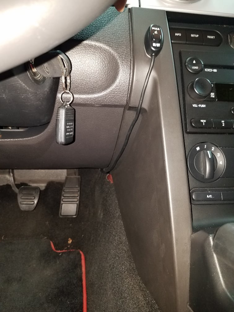

I don't see why not. It's very tight in there with the steering column, wiring and so on. I gotta believe that lower panel in held with clips.
I just posted the picks for a visual. I would think that portion just unsnaps, which allows access to all below the column. Positive is that panel isn't behind the radio like mine lol.

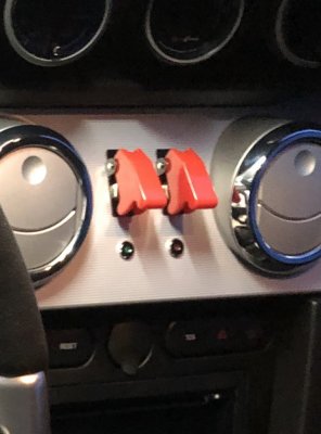

Placement btw, why not to the right of the head light switch in what looks to be a flat spot. Buttons style like JJ427R has. I know the turn signal would be above it but that won't interfere with them. If doing three, 2 on bottom (most used) and 1 center above.
Edit: that lower panel pulls of with two screws. There is also a small opening below the head light switch.
