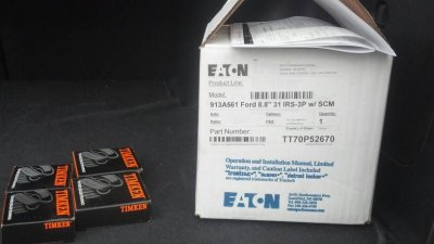

Ha! I knew it wasn't a Torsen. My first thought was eaton, but then I considered you might go for the "Wave of the future. Wave of the future. Wave of the future. Wave of the future"....and get a Wavetrac.
Good choice. Hard to break those from what I hear. About the only dual-duty unit out there (drag/road course). They came in the fairly impressive Roush Trak Pak cars too.

Torsens grenade when launched hard. And let's face it--it's a Mustang. It's GOING to get drag raced.
Two guys I autocross with have FF Cobra replicas with supercharged 302s. They both run Eaton TrueTracs and consistently come in first/second place by more than a second, every event. They also drive them to/from events (one of them has 100,000 miles on his TrueTrac) and drag race them occasionally.
Furthermore, the Eaton TrueTrac is half the price of the T2R. The only downside is that the bias ratio of the TrueTrac is "only" 3.7:1 instead of the T2R's 4:1. Interestingly, getting that high of a bias ratio requires running NON-synthetic gear oil. I contacted Eaton and they told me to use nonsynthetic 80W-90.
Interesting...I wouldn't have figured the lubricant would have anything to do with how the gears work. Then again...I can barely explain how a Torsen works.
