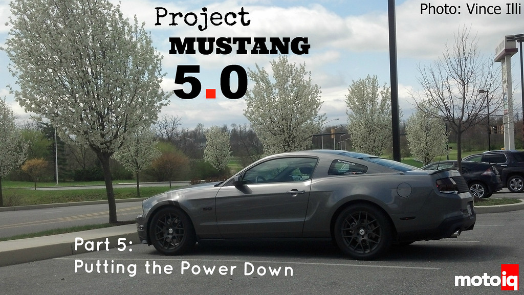

Interesting...I wouldn't have figured the lubricant would have anything to do with how the gears work. Then again...I can barely explain how a Torsen works.
It has to do with how the diff locks up. Look for another article explaining its installation and theory of operation in the upcoming weeks. :thumb:
Since I seem to be pretty much copying your mod list, about how much is installation going to cost us?
I was quoted 3 hours for just the posi unit. (It's more than that if you're swapping gears; mine are staying stock.) You also have to replace the bearings while you're in there. The bearings run about $40.

The only downside is that the bias ratio of the TrueTrac is "only" 3.7:1
Whoa whoa playa! Where you get that #? Specifically "the source". I've always wondered what it was because people either say it is 2.7:1 or it's somewhere between 2.7 and your 3.7. Never seen 3.7 definitively. If that's the case, I could care less about a Torsen T2R. Unless there is another factor to account for that I'm not considering.
Sky Render
Stig's Retarded Cousin
Feb 24, 2011
9,463
357
NW of Baltimore, MD
Sorry, Eaton claims 3.5:1:
http://www.eaton.com/Eaton/ProductsServices/Automotive/DifferentialsLockingDifferentials/PCT_317264
Also, a LOT of people outside of S197 forum use the Eaton TrueTrac for road racing and autocrossing. It's very popular in the FF Cobra crowd and those who road race older muscle cars.

First autocross with the new LSD is on Saturday. So far, I've only driven it on the street, but I REALLY like the TrueTrac.
