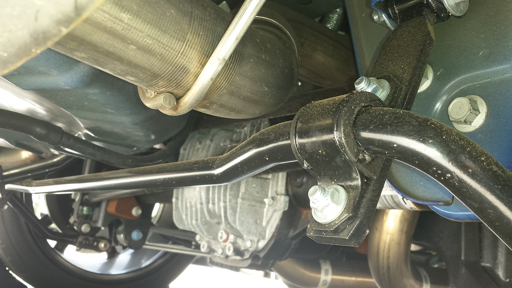

Reviving this thread. Today, I tried to get this bar installed. Went in perfectly; great fit and finish. The problem is that it hits my Corsa exhaust when it's lowered onto the ground:
I've been emailing Dylan and Kelly from BMR to see if they have any suggestions. I may just be SOL unless I want to change my exhaust (I don't).
Anyone else have any ideas? I could theoretically go to a "tighter" setting on the bar to get a bit more clearance, but then I'm afraid that my car will be too biased towards oversteer. I currently have the thicker BMR bar upfront.

Is there enough room in front of the bar to flip the drop link the other way? You'd still have to consider fore/aft bar movement over the range of suspension movements.

No, it would hit the Panhard rod then. :-/

The Strano/Hellwig rear bars use about 6.5" lengths of 3/8" x 1-1/2" flat stock for the riser portion, welded to a fabricated eye that retains the chassis side bushing. It's good for bars up to somewhere beyond 225 lb/in rating. It's not as pretty as the BMR piece, not by a long shot, but I bet that something like it, drilled for BMR's bar side bracket holes, would fit.

Norm, what you said about suspension travel made me realize the bar wouldn't work in any position; the drop link would still hit the axle-back on compression.
Dylan from BMR actually suggested the Steeda billet drop links. I might order them.

FWIW, my Strano rear bar also hits my Kooks exhaust at full soft (the mount just like how it is hitting yours). Have to run it in the middle or full stuff can't run it full soft.
Does it actually touch the exhaust at ride height when you have it on full soft?
I might try tightening the bar one notch to see how much clearance there is.

Mark, I have the Strano adjustable bar as well and have no clearance issues with the bar set on soft. There's an inch or so from the bar to the pipe and the link isn't even close to the pipe. I have Borla cans and the inlet is inboard on the muffler. Where are the inlets on your exhaust (Vince too)?

In your case Vince, unfortunately the exhaust you have takes up more space on the fore side of the mufflers than what jives with our links.
That being said...due to a few people that run into this, we are looking into making a fix. We really do not like to have to tell people to get something else, to make our products work.
