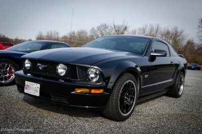

Just saw this
High five for another one with the GT4s. I have black with polished lip 18x9 and 18x10
I think they look awesome and are lighter than GT500s along with a lot of other wheels. I forget exactly what they weigh but they are something like 24 or 26#. Eventually I want to throw the rear ones on the front just to see what the fitment looks like and if I can get two more 18x10s
I have no idea why these wheels were never popular. Everyone that sees my wheels loves them.

Some pics of mine

I think they will look good on the black car. I currently have the FR500 18x9 black/polished lip. Just wanted to to change things up and these were on clearance.
Those look great on your car!
