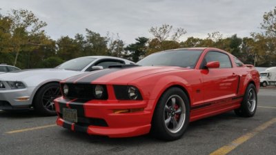

From your images you posted, I wasn't quite sure if your rims are "OEM" stock or not, which was my reason for asking lol. As for the stock, Pirelli's are concerned, I totally agree with them being one of the noisiest tires to own. They also have horrible traction in wet/rainy conditions as well. That being said, I couldn't wait to get them off my car :biggrin:

Rims in my pics are Chinese bullet knockoffs. I adapted stock
center caps, so they kind of look like they could be stock.
I also have stock 18 x 8 rims with stock 235 pirellis and
another set of bullets (18's, 10's and 8's) for my drag
strip setup.
