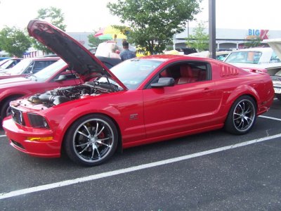

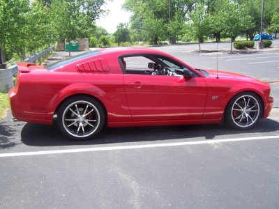

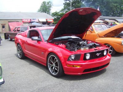

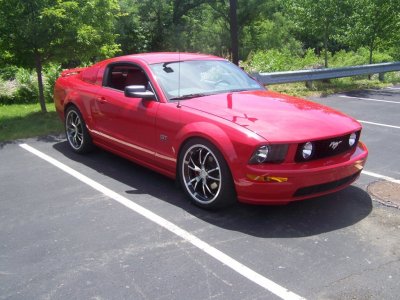

I run 275/35/20 square on 9.5" width wheel with 45mm offset.. They have more than a wide enough stance and height for my particular application purposes.. No complaints at all.

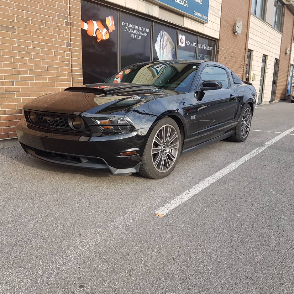

The OP has a 2010 GT, black, same as mine. Currently I use a 285-40-18 rear..and a 275-40-18 front, all 4 on 18 x 10 rims..and all 4 are ET-45. That puts the rears barely tucked inside the rear wheel well, with a tiny bit of sidewall sticking out, like 1-2 mm. That's with the WL watts link tweaked correctly.
I used steeda HD adjustable camber upper strut mounts, with the camber maxed out to aprx 1.9 degrees. That puts the front 275's well inside the tops of each wheel well. These cars handle better with some neg camber on the fronts. They brake + handle real good with either a 275/285 front.
Wider tires, + correct ET, increases the outside to outside track at both ends of the car. That's about as good as it gets. I have zero issues with tram lining, but forget what the toe is set to. I can't really hear any tire noise with the LT's, even at low rpm's... or coasting downhill, with eng off. (I do that once in a while, late at night, so I don't wake up neighbours)
