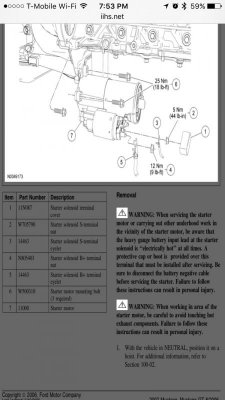

its wired like you describe. google "online mustang manual fsm". go to the iihs.net link then to wiring diagrams/starter wiring. sorry, my ipad will not let me give you a direct link.

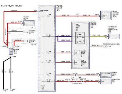

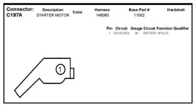

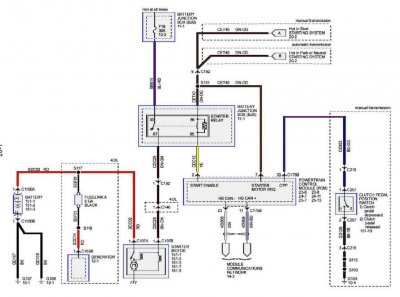

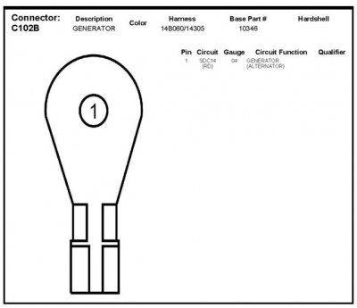

I attached a few diagrams of the systems you are referring to and what the connectors look like.
Large Pos battery cable goes to: Starter Motor & Junction Box
Small Pos battery cable goes to : Alternator
Battery Ground cable goes to: Strut tower & Engine Mount

Thank you guys very much. At the end of the engine harness directly after the ac compressor connector there is a pigtail connector. Is that what goes to the third terminal on the starter to tell it to engage when the ignition is engaged?
Switchback
Aug 12, 2015
21
Kalamazoo
You've got 2 cables that go to the starter a constant hot and a hot when the starter solenoid is closed. If the cable you are thinking goes to the starter and it looks like one of the two in this diagram, test it. It's the only way to know. No one knows what your talking about unless you take a picture of the wire you're confused about.
