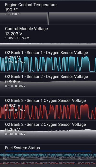

Returned to stock and my Blue driver scanner only supports front O2 sensors. Reads all 4 when Brenspeed tune is installed. Is this normal?

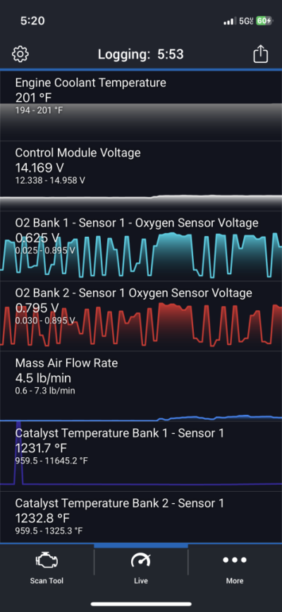

I’m curious if anyone who runs stock can only pull data from front 2 sensors and those with a tune are able to pull data from all 4 O2 sensors?
When I’m on stock tune the rear O2s says not supported. When I have my tune loaded I’m able to pull live data for all 4 sensors.
1st on this trend is stock tune. 2nd pic is with 93 octane tune.
