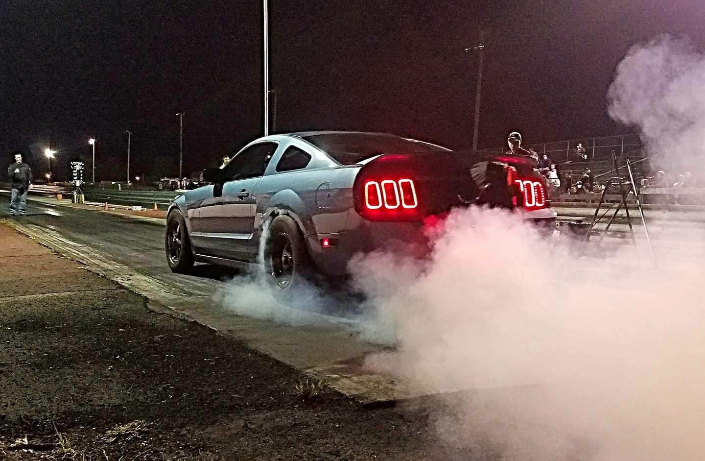

Need some setup advice! I can only get the car to hook off foot brake on a perfect surface.
Vortech JT 25psi, 4r70 auto 5200 stall, 4.10 rear gear.
KM018& AA010 up front. Viking double adjustable coilovers. AP valving 200# spring.
XSB012, CAB005, UCM002, UTCA033. 13 Cobra Jet springs out back. Top hole uca mount, middle for lcas. I have bmr springs to go in the rear to replace the CJs.
Feels to me like front end is just way to stiff even at full loose. Not sure if control arms are just bound up or if the spring is to heavy.
It'll 60 1.29-1.32 off foot brake on a perfect prep.
It instantly blows tires off when I use trans brake.
