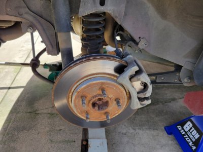

Can't believe how heavy the wheel and tire are. Everything went pretty smooth.

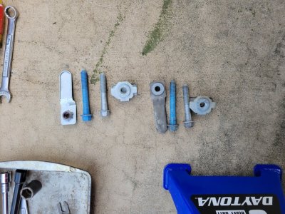

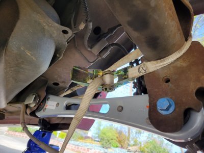

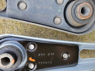

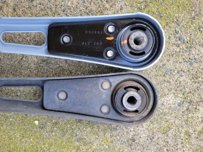

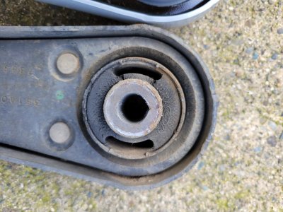

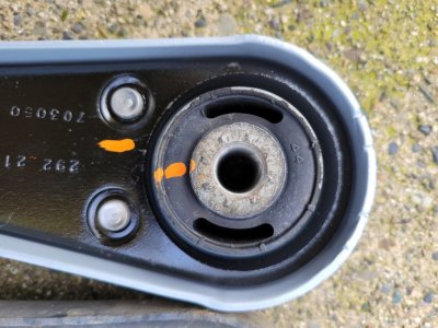

Ford GT500 LCAs came with new hardware. Had to use a ratchet strap to align the holes.

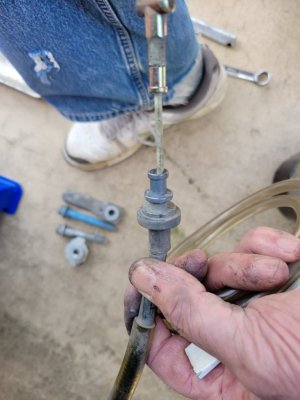

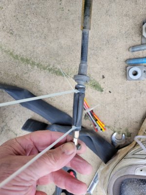

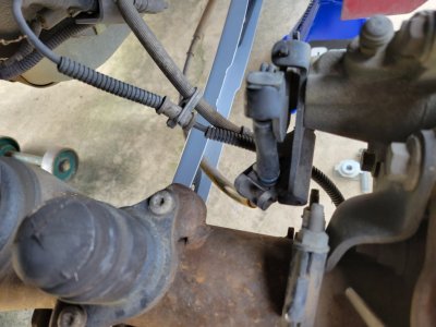

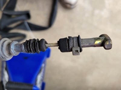

Ran into an unexpected issue. The E-brake cables acordian dust covers were rotted. While I was trying to figure out the best way to tackle it I noticed a tube that I had just changed out of a bicycle. I cut it to length with the cable in the loose position like a wrist band, put it over the cable, then folded it around it and tie wrapped it down.a16.jpg a13.jpg a12.jpg a14.jpg

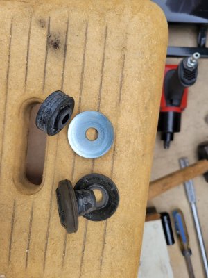

I used the top nut and shock bumpers from the stock shocks. I thought that they were a much better design as the hole for the top mount is quite a bit bigger than the shaft and even bigger than the raised edge of the bushing that Koni supplied. That would have let the shock migrate around it seemed and the stock setup really locked it into the center of the hole. When I tightened the top nut down I basically ran out of threads as the Konis bushing was thicker. However I believe the rubber bushings were compressed a sufficient amount with the nut bottomed out. That's the Koni bumper on the top and the stock one below.

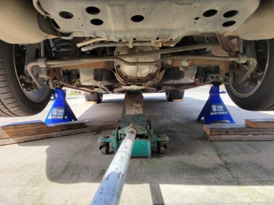

I torqued the Sway bar links top bolts to 85 Ft lbs and they were about a 1/4 turn loose. I torqued the shock lower bolt to 85 Ft lbs and attempted to tighten the top nut to 10 lbs but the shock shaft just spins so torqueing it was a no go. I use a 15mm wrench and a 1/4 inch wrench on the top of the shock shaft that they engineered into the shaft for just that reason I am sure. I then jacked up the car at the pumkin, taking the weight off the jack stands thus loading the suspension and torqued the LCAs to 129 Ft lbs front and rear. I know that should be done with the car level but there really is no way to do that unless you were on a drive on lift. I'm hoping the tiny difference if there even is any won't be an issue. I understand the reason they want it sitting like it's going to on it's tires when your crank those bolts down. You are effectively clamping the steel sleeve into a set position so the ideal position would be where the car spends most it's time. If you torqued them down with the suspension unloaded they would be clamped in that position. Then when the car was sitting or even worse when the suspension was fully compressed that rubber bushing would be twisted a lot more and possibly past it's design limits.
I took it for a drive and the seat of the pants feel was very good. I could tell it was firmer and the metallic clunking was gone. However the crappy roads did seem a bit more crappy. One thing that really surprised me was changing lanes on the freeway. Before when the tires would hit the dig outs for the reflectors the car would lurch sideways. I had assumed that was from the front suspension. Well it doesn't do that anymore and I have not replaced anything up front yet.

Your way to torque the bolts is fine. I used ramps and no problem since years. An other option to get the axle aligned is to use a hydraulic jack in parallel to the axle tube, lift it a bit near by the wheel and push the jack together with the axle to the front (can make some scratches on the floor).
