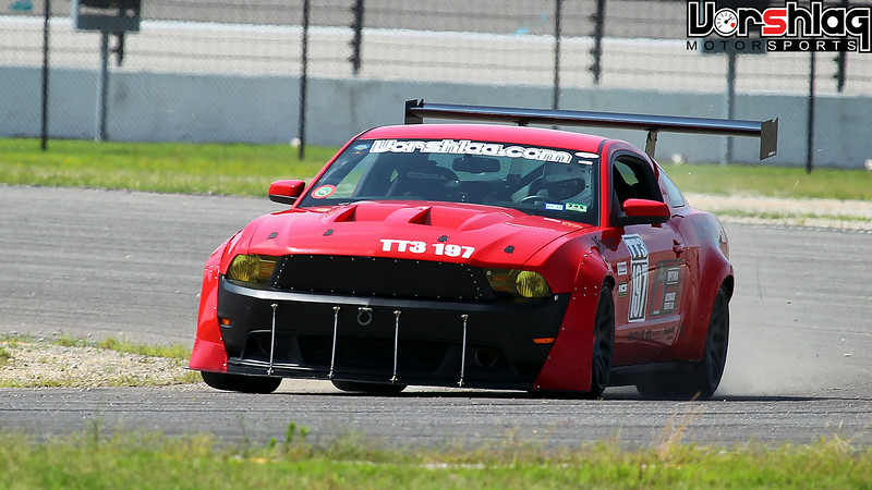

You are oversimplifying the benefits of larger and adjustable anti-sway bars. These exist even on F1 cars (and don't even get me started on FRIC, which is essentially a front-to-rear hydraulic swaybar system used in F1 - until it was banned), and they do have their place on all modern sports cars when used in competition. Yes, many people go to big swaybars FIRST and they often get used as a CRUTCH for proper spring rates. That is very very true. But even when you have increased spring rates DRAMATICALLY firmer than stock, with appropriate dampers to match, you will likely still benefit from larger than OEM bars.
Don't take every damned thing you read on the interweb at face value - even what racers or suspension designers or vendors (like me) write. The only way to REALLY know what works is to TEST IT. I have 27 years of competition experience so I have built my own set of "theories" but I always question the "common way of thinking", even when it is my own. When we had tripled the front spring rates on our Mustang (above) with AST dampers we did a timed autocross test. Using BIG adjustable Whiteline swaybars at both ends we did a full sweep on each bar, from softest to firmest settings, and we let THE CLOCKS DECIDE what was faster. Guess what? Full stiff on each bar produced the lowest lap times. I would NOT have guessed that.
We eventually took the tripled spring rates and DOUBLED them again, and now we need LESS bar, but we still dial in what the clocks say is faster. Even with 800 #/in springs we still get some serious body roll without some swaybar in there to control things...
