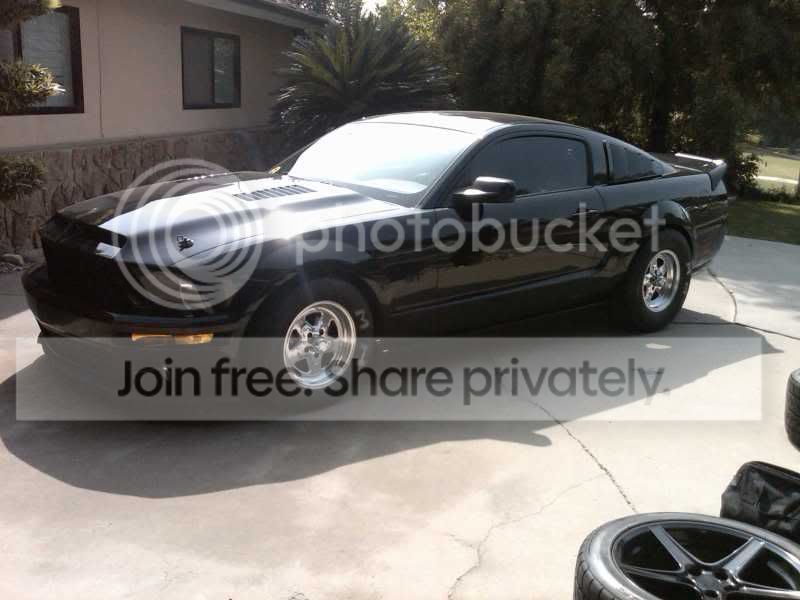

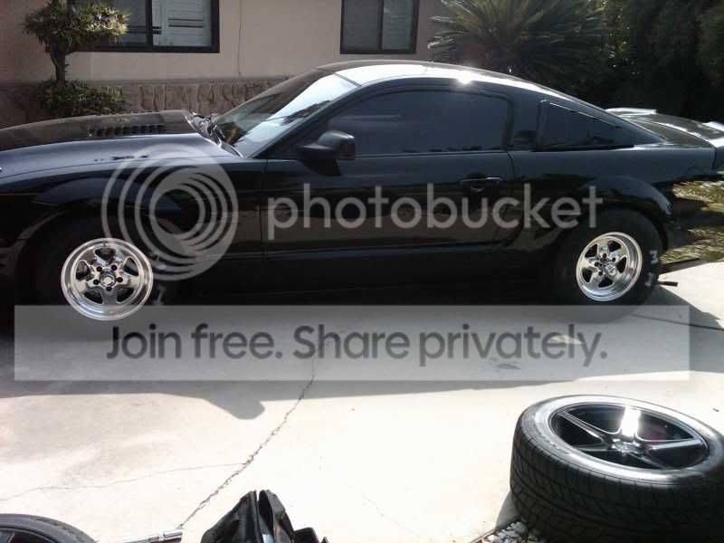

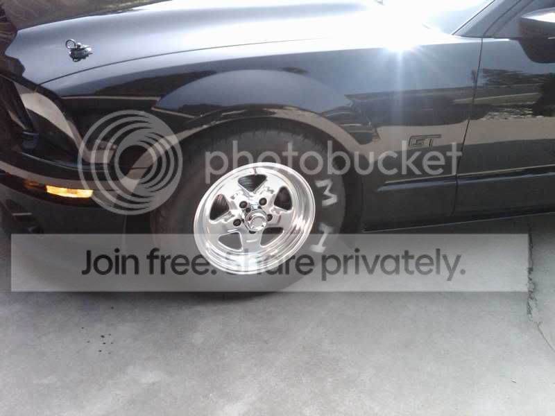

ok guys here it is.....
just got back from m/h after getting my front runners and rear drag radials put on :beerdrink:
here are a few pics i took once i got home
front runners are 185/75/15's and the rears are the 275/60/15's.
had to grind the rear calipers to make them fit a few weeks ago. thought the fronts fit fine with the 3/8 spacer BUT after putting them on when i got home i found out they have a SLIGHT rubbing issue. not as much as the rears but just a little bit. still spin the rims over the calipers but i can hear and see where the rubbing is. shouldn't take more than a little bit of grinding of the front calipers to get them to fit perfect :beerchug2:
Quick question... Where can i get longer lug nuts to fit on these? i used the stock lugs and they hold ok but when taking them back off it didn't take that much pressure to get the lugs loose. just want to make sure i get enough thread in there for a secure hold before i run them.

hey mikey, how much grinding of the rear calipers were involved? i tried to put on my jegs 15x8 rears last night and the tire locked. btw, i have an 08.
mikeysgt
Mar 4, 2009
7,039
28
Bakersfield, CA
it took quite a bit of grinding to get the rears to clear the calipers. i'd say a couple of mm's at least. i had my mechanic do it for me while he installed my anti-squat bracket and adj panhard bar for me.

i would but i painted over the grinding last week when i painted my calipers black. you can tell what you're grinding once you get them on... it's the outside edge of the calipers... i'll be doing my fronts next week when i get some time
