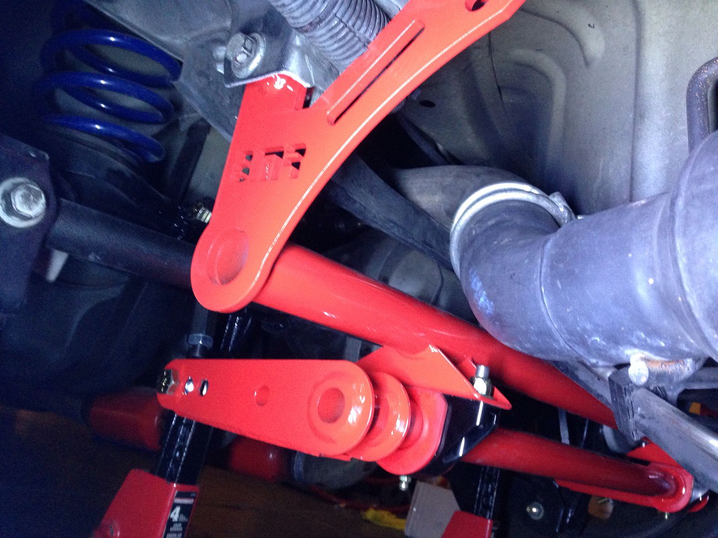

Thoughts on these sway bars?
07 Boss
Jan 25, 2009
4,300
1,417
Sin City

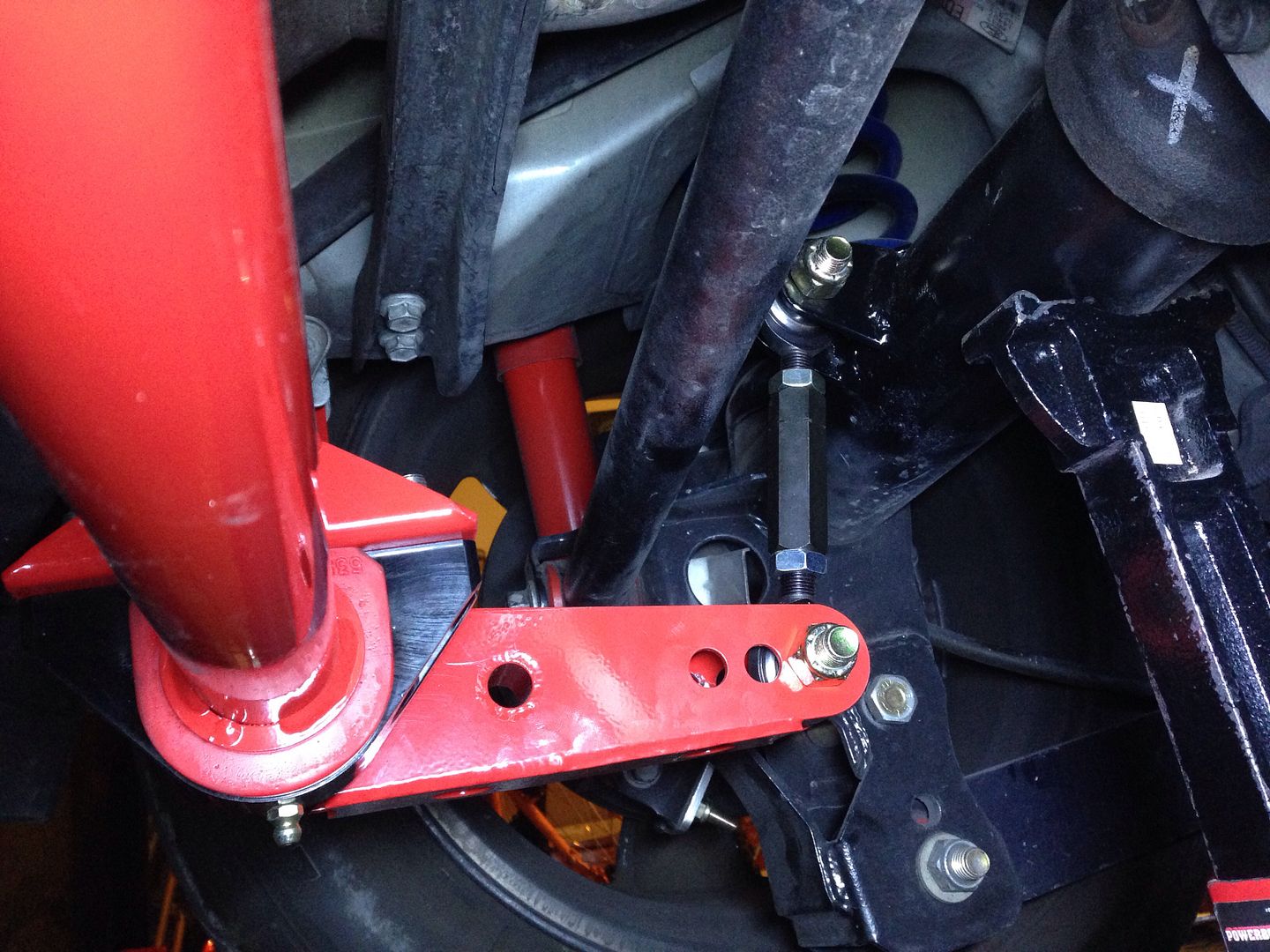

That's not as sway bar...
This is a sway bar.
And these are proper endlinks.

And 07 Boss, that's not a sway bar; that's an anti-roll bar. There's a difference. The bar you have is to prevent chassis twist on a hard launch. A sway bar is for cornering performance.

Kind of the same thing, really.
Both operate on principles surrounding chassis roll. Just that the sources of roll are different (lateral g's vs engine torque reaction) and the intentions differ (balancing handling vs re-planting the "unloaded" RR tire during acceleration).
But I suppose it's a good thing that the dragstrip crowd calls it something a little different - those bars are generally a lot stiffer than you'd ever want for cornering purposes.

Same same. Stabilizer bar, roll bar, anti-roll bar, sway bar, anti-sway bar, they all do the same thing and the there really is no difference. All depends on where you come from and what terminology you use. They work the same to achieve the same goal. Depending on what style of driving you do is going to determine how stiff you want to go.
