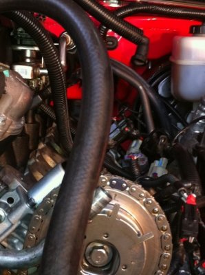

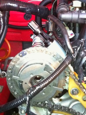

Is my alignment correct?
Cam1.JPG This is at the 6 oclock postion
cam2.JPG I made this one a large pic that way you can blow it up
cam3.JPG Don't know why these last two pics turned sideways

Looks good provided the first pic is rotated 90 degrees and everything is pointing down to 6 o'clock.
Edit: Just read the caption. Yes, it all looks correct.
Did you go with 350's?

Yes it is I don't know why my Iphone turned the pics sideways. The dot on the crank gear is down towards the ground and is close to 6 oclock as possible. My real question is how does my cam phasers and chains look? Are they in the 11 and 12oclock position. Notice how the right side of the car is pretty much dead on the 11 oclock position and the left side is after 12oclock just slightly not much but slightly...
Yes 127350s locked out

In the first pic, is the rear chain black link in the same position?
Cant tell from the pic. If so then it looks good.
Are you going to prime the tensioners before you start the car?

Yes for sure since I had to compress the passenger side tensioner. Yes both links are on the bottom of the crank gear in line on the same tooth
