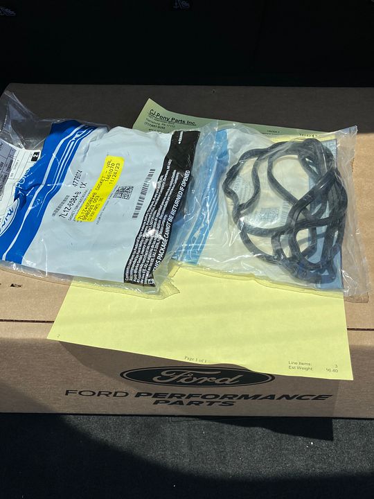

Well stopped by CJ Pony Parts and picked me up a new timing set and valve cover gaskets. Also picked up an extra FelPro main seal for the front. My las one leaked a little so I bought a different one hoping I'll have better luck.
I will probably repaint my front cover while it's off and get a new set of pulleys so I can get her back to the way she was.
