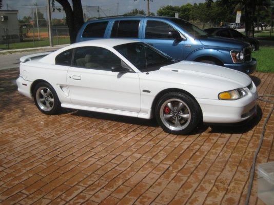

That is ironic, I had Cooper Zeon RS3-G1 255/40-17 on my old 1996 GT. They replaced the Goodyear Eagles which were 10-year dry rotted... I was pleasantly surprised that they performed so well for an economy sport tire. Sold the car to the kid down the street a few years ago and cool to still see it running around on those same tires.
