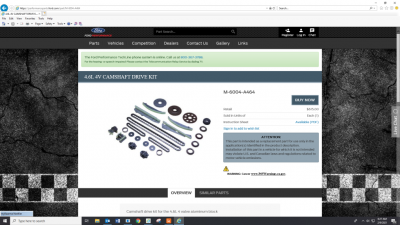

That is not for the 3V. This is the right kit I think. But don't know if it is original Ford parts or aftermarket:
https://www.ebay.com/itm/Ford-4-6L-...2&hash=item2cfed07c79:g:FKYAAOSw3I9d8mw4#rwid
Yes, that's the correct Ford Performance kit for the 4.6 3V (Part # M-6004-463V) and is exactly what @TANN3R_ needs. It also includes the phasers plus phaser bolts so it's a complete front cam drive package.
The part no. M-6004-A464 is for the '96-'04 4.6 4V engines. The last three digits of the part # gives you the clue.
