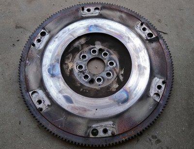

Once you start doing clutch burnouts, you need to replace the clutch kit, and consider a new flywheel since it's probably gonna have all kinds of heat damage
