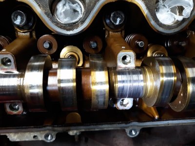

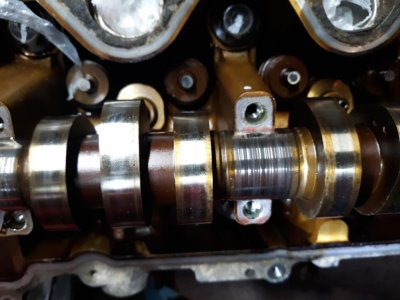

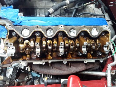

this is all the drivers side,,, also the worst side,, as you can see , the cam towers Arnt scorned much at all , including the caps,, the cams tho ,,,, whooooooooo,, i guess i should order some stock cams
Badd GT
May 19, 2013
816
411
wake forest nc
Everything that I see has the brown glaze on it so I would think nothing has been replaced. I wouldn’t replace anything if it’s working properly, just change your oil every 3-5 thousand miles.
If you “need” new cams I have my factory cams still 75,000 miles
whitmanink
Dec 28, 2020
667
342
denver pa
i found a set of stock cams for $180 , i think im gonna go that route to make sure it will wear more even ,,(im hoping) unless others have pics of what there cams looked like, id rather replace these,, as you can feel the ridges in the cams
