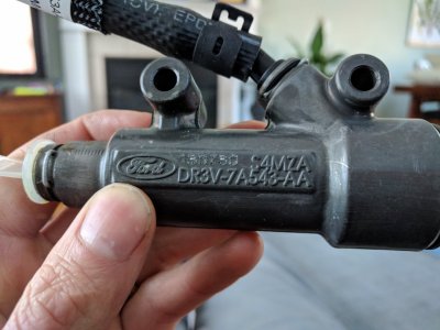

The 2 parts that stand out to me are the Master Cylinder and Slave Cylinder. The hose line is rated several times higher psi than what it will ever see in the system. But a braided line is a common place upgrade and easy to do. The slave is probably the least complicated part in the system. It's only function is to push the pressure plate utilizing hydralic pressure provided by the Master Cylinder. A failure on the part of the Slave would involve either a failed bearing or leak, and the leak would be visible. With exception, depending on the specification of the pressure plate depth, the slave may need to be shimmed to position it within its proper throw range. This is likely why the Exedy is among the most popular choice of clutch, as it follows on point or very close to OEM dimentions, making it relatively plug n play. So I don't feel the Slave is an issue when it comes to clutch problems, bar the minor exception.
The Master Cylinder is the key component in the hydralic clutch system. If you have a problem with your clutch, IMO it's going to come down to this part. The OEM unit in the S197 GT and most GT500's is a plastic body. This should cry foul from the get go. Plastic is notorious for warping under heat and pressure. It's also worth note that there are far fewer OEM clutch setups with complaints than there are aftermarket clutch setups with complaints. Aftermarket clutches generally have higher clamping force via inertially heavier pressure plate. Now the Master Cylinder must provide additional hydrallic pressure beyond it's OEM rating. It is my opinion that the Master is flexing/warping under pressure, causing the interal seals to leak by. If the seals leak, there may not be enough pressure provided to the slave to push the pressure plate completely off the clutch, thus grinding gears, hard to get in 1st/reverse, and idle rolls with depressed clutch in-gear. The '13 GT500 Master is a metal body, better seals, better design. It has a different dimentional throw than the OE GT Master, which is where the hunt begins for shimming the slave. In most cases, with no shims, the engagement point is going to be higher on the pedal compared to stock. Personally, I don't feel it's an issue, you get used to it fairly quick. Could it over-throw the pressure plate? Possibly, but not by much. I ran it for years before I sold the car and never had clutch issues after the GT500 MC went in. For those He-Man shifting their gear box, congratz on your world-class bench pressing, and enjoy fixing your gear fork, you fucked yourself jackass. If you have to flex a bicep to change gears, you're either doing it wrong or setup is so jacked you should stop driving it before you cause more damage. For those who already ground their synchro's out of existance, *shrug* fix em, or buy a reman, and get yourself a GT500 MC. Stop missing gears!
What year GT500s came with the plastic body Masters?
'07-'12 GT500's all came with plastic body MC's. I think the major difference between the GT and GT500 MC's (for '05-10, anyway) was the bore size. GT500 was a bit bigger, but it's been a while so don't quote me on that. When they introduced the 5.8 monster in '13, they beefed up the MC, as I'm assuming they realized they needed better components to address the higher clamping force needs.

I have a 2013 GT500 MC. It is plastic.
I had the 13 GT500 MC as well, and mine was metal. Perhaps they changed them in a design update? Will have to dig up the old thread as there was some debate as to what part number people were ordering. It looked plastic in description pictures, but when I got the package, it was definitely metal. Larger cylinder bore as well. I didn't use any spacers with my Mach 400, given the engagement point with the master, I think a shim would've been overkill.

The big issue with the OEM Master Cylinder was the seals were leaking-by not providing enough hydraulic pressure to the slave. If you lose throw at the Master, you'll lose throw at the Slave. I measured the distance from flywheel to the tips of the stock PP fingers and found the measurements to be the same as both the Centerforce DF and Exedy Mach 400. There was no shims on the OEM slave, and both doorman slaves I used on each clutch swap were the same dimension as the OEM slave. So why is shimming the slave necessary if it's not done at the factory? It seems to me that shimming the slave is a bandaide to cover for the fact that the Master is losing pressure by the internal seals. I can't speak for other clutch models other than the OEM, Centerforce DF, and Mach 400, as those are the only ones I owned and had physically put a tape measure to. In the instance of an aftermarket PP that matches OEM dimension, I think shimming is unnecessary. In regards to any tranny other than the 3650, shimming may be necessary. I don't know, I only ever ran my stock 3650, but I never had a slave issue, it was always the OEM Master Cylinder problem. All my shifting/clutch issues disappeared when I put the '13 GT500 MC in. Aside from having a higher engagement point on the pedal, which I found highly preferable for fast shifting, never had lock-outs, grinding, hard to get in gear from a standstill, none of it. The only thing I wish I had done in addition, while swapping out the MC, was to purge the line and install a separate fluid reservoir and cap the brake reservoir, and use Dot4 fluid for the clutch system.
