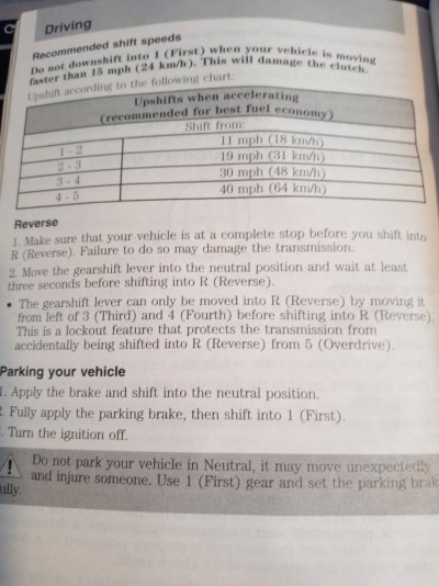

I have a MGW in my '05 and have the same issue. If you have the owners manual, look in the chapter on how to shift the 5 SPD. On page 162. I couldn't believe it either, until I tried it. I often have to sit there and wiggle the shifter back and for in neutral and partially release the clutch in 1st to get it to engage.
