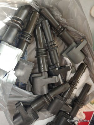

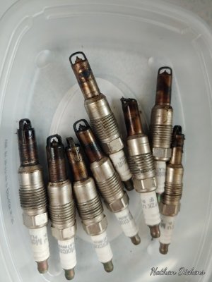

Well im pulling the rest of the spark plugs an coil packs an will update with pics

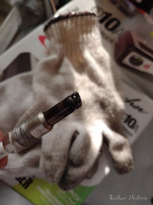

So here's pics of all 8 spark plugs an coil packs, aslo when i pulled spark plug number 8 the end of the electrode looks like its been smashed20191101_111440.jpg 20191101_111511.jpg 20191101_111440.jpg 20191101_111511.jpg 20191101_111540.jpg

You need to do a compression test asap. There is no reason that plug should have a smashed ground strap like that unless it was installed that way or there was/is a foreign object in the cylinder.
Sep 14, 2019
101
Only thing i could think of was, that could have possibly done that was when i was staring it yesterday an was revving up the engine other wise it would die out if id just let it idle an it was missing real bad but never heard any knocking an i never took it past 3k rpms.. I just cleaned up the spark plugs an coil packs and im gonna see what happens...

Jesus!
That is some serious damage.
You had to have gotten something into the motor. Looks like one of the others has damage too.
Need to compression test it and/or scope at least that one cylinder.

Jesus!
Yea i was shocked when i pulled it out... Also i did replace 2 coil packs about 5 months ago pulled the plugs on the 2 fairly new ones an 2 of the older coil packs an they all have unburnt gas oil mixture on them... Referring to coil packs though i know of that atleast 4 have been changed since i got the car an still has the same factory 4 that came on the car... So could possibly all 8 have gone bad? Or most likely the 4 stock coil packs went bad? Or maybe my compression is so low it is causing it not to run but i know it seems like my coil packs are not firing either cause there shouldn't be an gas on my plugs...
