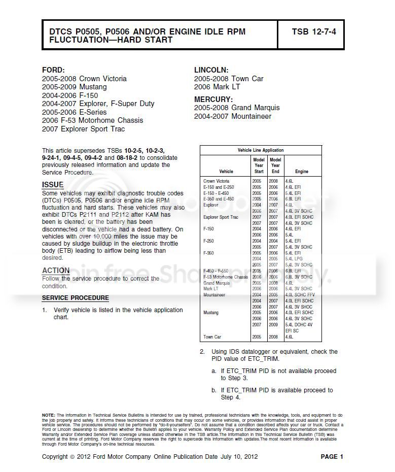

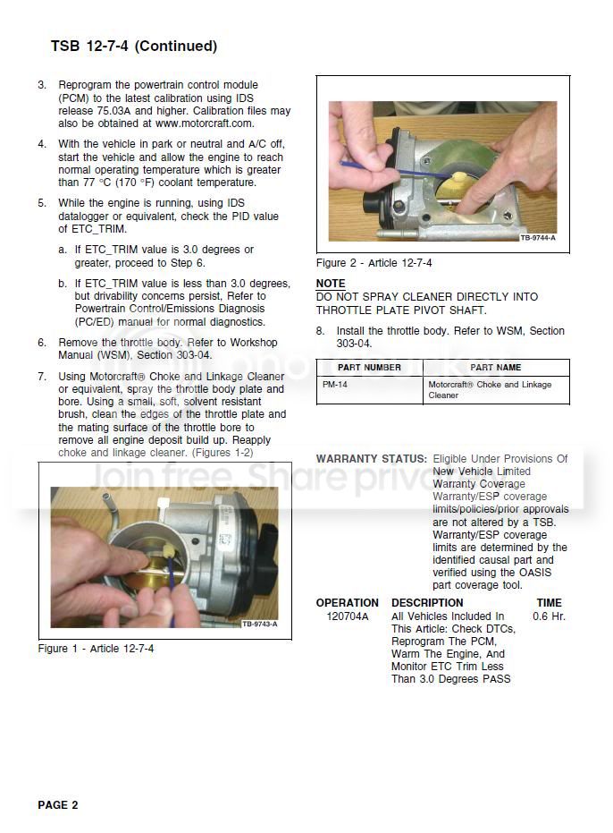

TSB 12-7-4
DTCS P0505, P0506 AND/OR ENGINE IDLE RPM FLUCTUATION - HARD START
