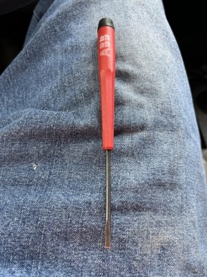

Just replaced all mine, kinda sucks but not to bad. I used this tool to pry the old ones off and just pushed the new ones on. Didn’t use any lube or anything but it’d prob make the job much easier. By the time I got to the last one my fingers were TOAST!! Using dykes to cut them off might have been easier or a box knife
