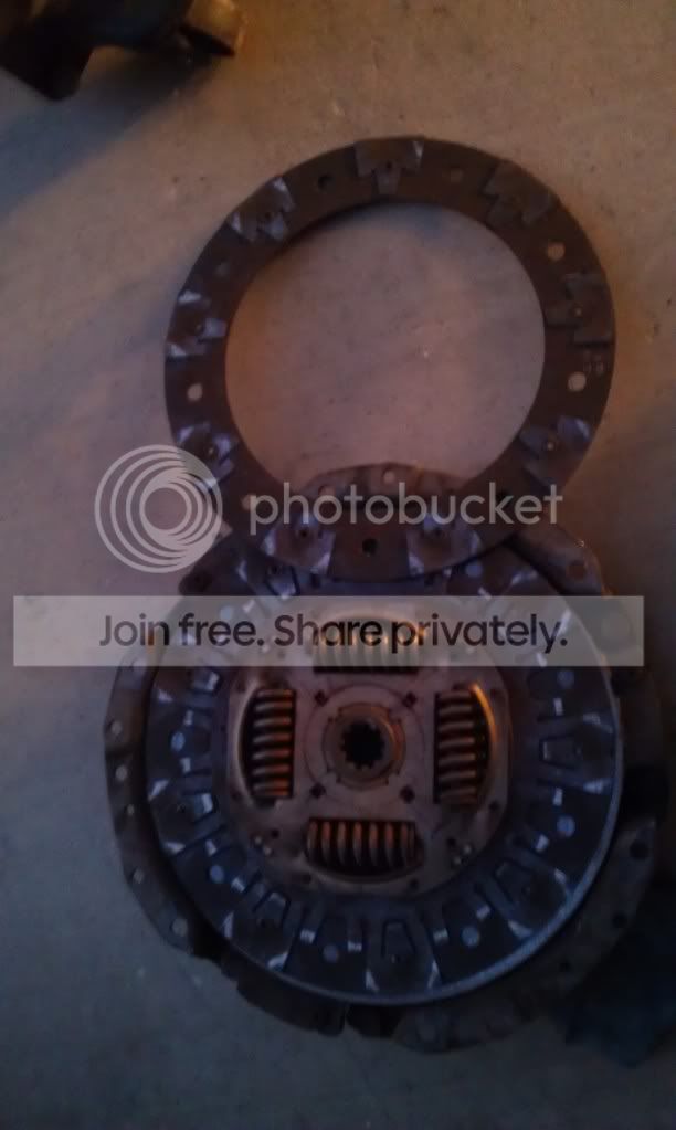

Are you manual trans? If so, i had a similar issue that turned out to be this:
(pulled from my own vibration thread)
Looks like your first suspicion was correct. I've been sitting on a replacement clutch for about a year and a half and 37k miles ago. Stock clutch finally replaced at 138,567 miles and looky the disk.
Shitty cell phone pic, but yeah. One side of the linings just completely sheared off of the center plate. Pressure plate had some fingers loose also.
I still give it up to the factory unit. Couldn't of asked for anything more from it. I did replace it with another stock unit also.
