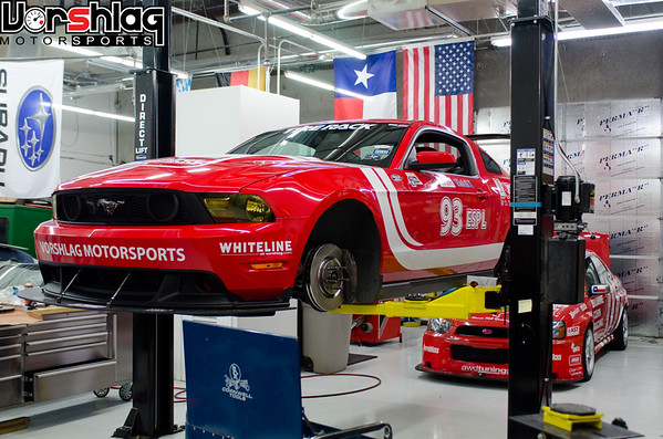

During the reinstall of the calipers one of the M12 bolts stripped out the threaded hole in the aluminum caliper - which figures, because Ryan asked for new calipers 2 months ago, and I had said "Nah, these are fine..." We figured these holes have been screwed and unscrewed close to 150 times, so it was time to replace them. We couldn't get a replacement caliper on the 3-day Labor Day weekend and were set to leave early Tuesday morning, so I picked up a heli-coil kit at a local NAPA and Ryan fixed that on Monday.
Terry (or anyone), do you consider a heli-coil fix to be a "good as new" repair to a caliper, or only a stopgap measure with the better/safest option (especially for track duty) being buying a new caliper? I just stripped one of the holes myself and am debating what to do.
Vorshlag-Fair
Official Site Vendor
Nov 12, 2010
1,592
116
Dallas, TX
Honestly.... if done right a (steel) helicoil thread repair insert on an aluminum part should be as good or even better than new. A lot of engine builders will helicoil threaded holes in aluminum blocks, just to make them stronger, for instance.
These front Brembo calipers we have on this car have seen so many cycles on and off, and so many hundreds of track miles. The seals and dust boots are burned up (again) and every threaded hole and even the pin guides are showing some wear. Even though they are still functional we have new Ford/Brembo calipers that will go onto the car shortly, just to be safe. But the old calipers will still become spares...
