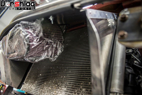

This new mega-splitter (10.25" long at the nose) should make considerably more front end downforce than the 5" long ABS plastic Leguna Seca splitter did before, and hopefully it will help with cooling (which is also more difficult in thinner air) as well.
Left: Since she won't let us cut on OEM sheet metal, we bought another hood. The 19" wheels are on for "ease of pushing". Right: Proposed ducting.
We have moved some things around under the hood in order to make room for the large holes we're adding to the hood (a used 2010-12 stock aluminum piece) to better pull air from behind the radiator. The OEM coolant reservoir is no longer sitting behind the radiator on the right side, it is now relocated off to the left side of the engine bay, out of the airstream we're adding.
New bumper beam is 1.75" x .120" wall DOM tubing and it bolts on to the frame rails. Plenty strong, but less bulky than the OEM beam.
The cold air inlet tube is no longer blocking the left side of the engine bay like the factory routing. Now it goes over the top of the radiator support towards a Corvette style air cleaner located in the space where the old bumper beam was. A new tubular bumper beam replaces the stock piece and will anchor the down-stays for the splitter as well as a tow hook. It looks like the 3" diameter tube snaking over the radiator support wouldn't fit under the hood, but this 3" aluminum tube (with a MAF sensor plate welded in place) does clear with the hood down. The hood has been clearanced on the bottom side (two of the three layers of aluminum were notched), the center mounted OEM hood latch is gone, and the hood will be held in place by four aero latches.
Left: Radiator ducting coming together and air inlet looming above. Right: Ghosted image showing the insides.
These changes seem like trivial things, but it took a good bit of fabrication work to re-route the inlet tube and to relocate the coolant reservoir. The added "real estate" behind the radiator and in front of the engine will have some "waterfall" air deflectors we create down in there. These will help push the incoming air aft of the radiator up to the hood openings. These will not be 100% perfectly sealed, but it doesn't have to be to still gain some significant front downforce.
Left: Upper grill block off plate and new "sacrificial bumper cover". Right: Cold air inlet plumbed through radiator ducting.

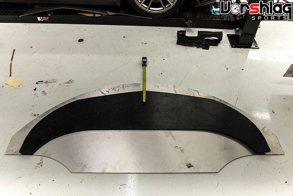

The splitter we made is from sheet aluminum (6061-T6) that we had water jet cut to our drawing. It is very big. The picture below shows where Ryan was with the fab work on Monday the 12th, but we've gone much farther than that by the time you read this.

...Although, do you think that the 10 inch splitter will be worth all the extra drag?...
The splitter is only 4" longer than the Laguna Seca splitter. And we've extended it back under the engine, eliminating the lip that is normally at the back of the OE splitter.
You can see the Laguna Seca splitter overlaid on our new splitter.

Ahh okay. That picture makes it clearer. I was imagining 10" out in front of the car. lol
It isn't 10" out in front of the car... it is 10.25" out in front of the car. :naughty1:
Tape measure starts where the bottom of the CS lower fascia ends.
Last night we worked on a spacer (out of 1x1" aluminum square tubing) to drop it down 1 more inch lower
It is large.
