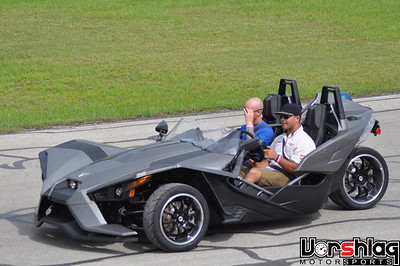

The crazy trike thing above was the pace car for some races, including this Blitz group (led and won by Paul Costas's GT1 Camaro)

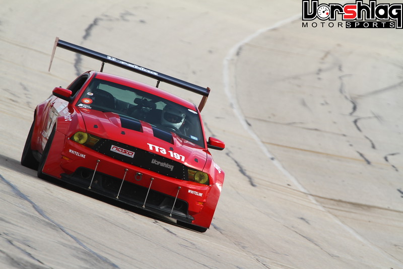

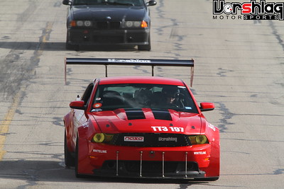

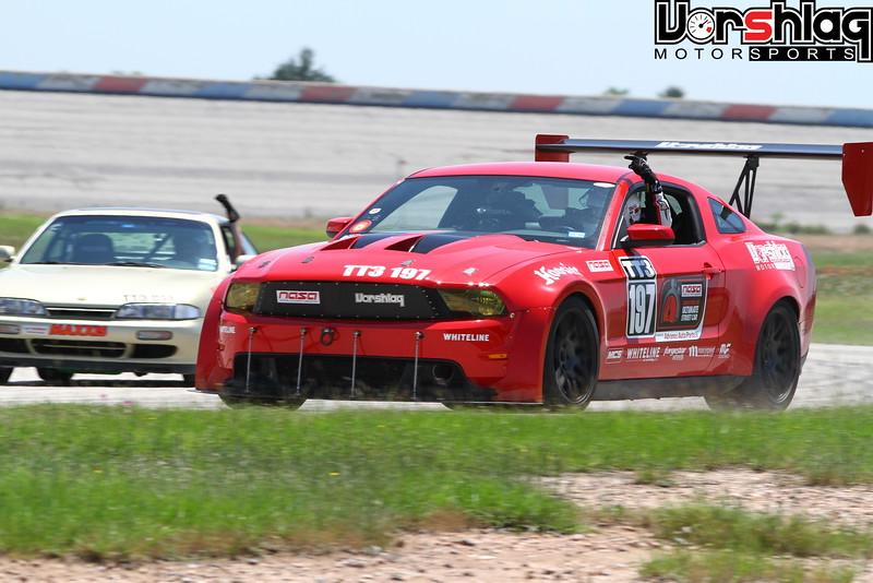

So we checked all the fluids and pressures and got the red Mustang to grid for TT Session 1, the coolest session of the day. With a dry track and cool air, it would be THE perfect session all day to get a fast lap in. Since I knew this car well (after 5 years) and knew this track like the back of my hand (my first laps were taken here in 1989!), I felt like I could get it done in a single lap. It was the LAST EVER event that TWS would have at TWS, so I wanted to cement our lap record in the books for good, and improve on our 1:50.6 TT3 record from 2 years ago.
Excuses: we should actually be about 2-3 seconds faster than our 2013 laps, with the improvements we made in the 2014 season, so I was still 4-5 seconds off the pace. With the wounded rear I was taking it easy going into Turn 1 off the banking, keeping it to around 140 mph on turn-in and braking early. Still, I REALLY wanted to improve upon our 2013 record, as this might be the last time we run this Mustang with NASA, if a buyer finally shows up (we're at 4 flaked out buyers and counting). So, the goal was nothing less than a new a track record and two wins.

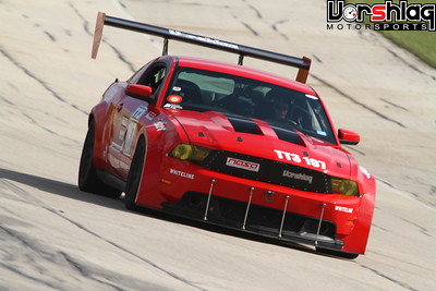

The one lap I drove on Sunday, in TT session 1...with data overlay
So my lone lap of the day is shown above, and with some careful gapping on the out lap I managed to get a traffic free lap. I was still feeling the tire rub on most high speed corners, which made me cringe, but I drove through it and managed to get in a clean lap. As you will see at the end of the video there was a big "off" by TTC Mini competitor BJ, who I race against in the TTC Corvette (when it runs). With the wet grass he was stuck and they had to roll a flat bed and tow him out of the mud, shutting down the session early.
After that 1:49.9 lap I felt fairly confident we had the win in the bag, but it turned out to be a 4.2 second lead over second which stuck all day. Amy went out in an HPDE 3/4 session but a DE driver went off track pretty hard and found something to run into, which ended that session after 2 laps. So she brought it in and called it a weekend also.
The sun came out and everything heated up, and in the end most of the TT field set their fastest laps in TT session 1 or 2, but 2nd place Andrew got his best lap in during TT session 3 (after we had left). We stuck around until noon, loaded up, said goodbye to our friends, and hit the road by 12:30. I watched MyLaps app for live timing on the way home, fingers crossed, and wasn't really sure we had won until later that evening - another "whew" moment.
So that worked pretty well - 4.2 second win over 2nd, 6th quickest in TT all weekend, 2 wins, new track record, won four more tires, took one lap to get it done Sunday, and the car was reliable even not being 100% going into the weekend. The new set of A7 tires still had plenty of life left in them when we were done, too.

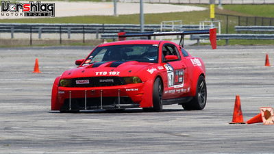

Texas Region SCCA Autocross - May 3, 2015

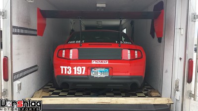

We haven't raced in an SCCA Solo event since 2014, so we left the Mustang in the trailer after TWS and just hauled the rig out to Texas Motor Speedways' asphalt "Bus Lot" and joined our friends with the Texas Region for this monthly Solo event. Since Amy and I signed up early enough we were able to get the work assignments we usually do - with me announcing and Amy working the timing computer, both of which were in the air conditioned trailer (and out of the sun).
It was a sunny warm day and they had an unusually large turn-out - 162 entries. We did nothing to the car after NASA @ TWS - just rolled it out of the trailer, threw 5 gallons of fuel in it, and slapped on some "SM - W" decals where it usually says "TT3".
They split up the drivers into 4 heats, where you run one, work one, and have the other two off. Amy was running the PAXed "Womens" class, running 1st and working 3rd. I was on opposite rotation running in Street Mod, working 1st and running 3rd. Amy would get cooler temps but a less clean course, where I had a cleaner course with higher temps - and those latter conditions favored the car.
Of course this car isn't set-up for autocross and hasn't been since 2012, but we occasionally run it in SMod, where it fits but is VERY heavy for the class. There is some archaic engine displacement-to-weight formula with a modifier for turbos, weight break for FWD and a penalty for AWD, but I lost interest in SCCA class rules 3 years ago and try not to pay attention to the seemingly constant changes. It fit there, so that's where I ran it. Shouldn't be competitive at 3800 pounds with driver (and 4000 pounds with a passenger on board), but a good suspension set-up and large Hoosier A7s don't hurt...

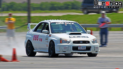

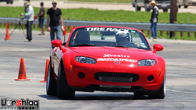

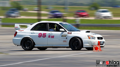

Old racing buddies Tim and Henry both ran against us in SMod in this 2004 STi, which we've worked on in the past

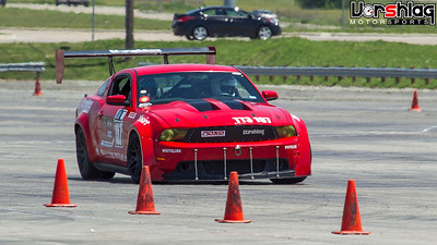

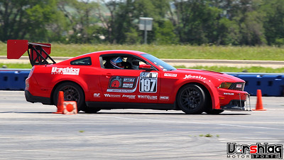

We grabbed some lunch in heat 2 then came back to the site and got the Mustang ready for my runs in heat 3 with StreetMod. Other than checking tire pressure and making some shock adjustments, we left the Mustang exactly as we ran it in NASA @ TWS (which worked pretty damned well there). I had riders lined up for all 5 runs (and then some), and never took a run solo. I had also forgot to bring the dang vidcam and other camera gear, so all the pics are from my phone or Brad's pics and there's no in-car video.

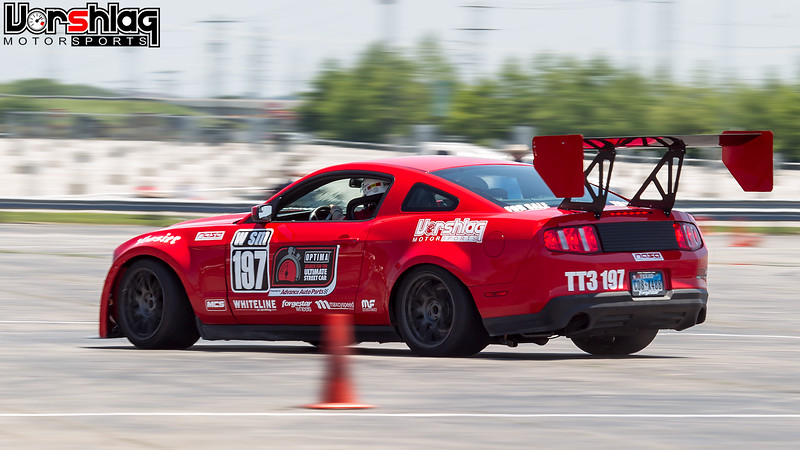

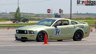

Jon from Vorshlag beat a large CAM-T class this day
I was feeling the car out (wow, it can LAUNCH now!) and managed a 43.3 on my first run, matching Amy's best. The temps were up and the A7s were GRIPPING. The course was also set-up well for this car, not too many slalom cones, with speeds topping out 2nd gear in a couple of spots (high 70s). This is the first time I've autocrossed the car on the 335/345 Hoosier A7s and I was VERY impressed with the mechanical grip. Of course there was little to no aero help here, but the big wing and splitter made people ogle the car all day.
I under-drove the car on my first run, but I didn't let that happen again. By run 2 the times were in the low 42s, and by run 3 I realized I was under-using the brakes. With warm pads the car would STOP but I had to really dig into the pedal. On my 3rd run I topped out 2nd gear in the first setion and went for the brakes very late, pressed HARD AS **** and something went POP! The pedal dropped down another couple of inches but the car still stopped. The rest of that run was weird and the pedal had a lot of slop in it, but I managed a 41.3 second time - Fastest Time of the Day (FTD) so far, by a good bit! Of course I coned it away.

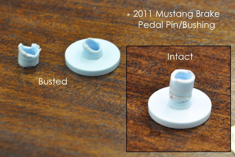

I managed to break this brake pedal cross pin after 5 years and a LOT of hard braking
There were people coming by and looking at the car more seriously after they heard the times announced, and the right seat was never empty. After this run I tried to see what was wrong with the pedal, saw the issue, but ran out of time and had to take run 4 with a broken pedal arm-to-brake booster clevis pin. The little plastic pin showed above is ALL that holds the pedal to the clevis, and when it shears the pedal can travel further before it eventually runs into the "U" in the clevis. Makes for terrible pedal feel!
I left the car in grid while I ran to our trailer to get parts, to repair the busted brake pedal pin
On run 4, fighting the busted pedal pin, I over-drove one corner and slowed down to a 41.8. I immediately got out of the car, sprinted the 200 yards back to the paddock (in another parking lot across the road), rummaged in our trailer and found an M8 bolt and nut, ran back, and made a quick paddock fix for the busted pin. It worked and I jumped back in the driver's seat in time to put in my 5th run, a 41.553 second pass, which was my fastest clean run. Much easier to drive with the pedal directly connected to the brake master cylinder, heh.

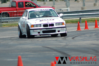

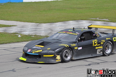

Setting FTD and Top PAX was easy in this V8 BMW back in 2007-09 - driving the Mustang on giant A7s made me fast in an autocross again!

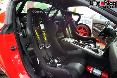

Then I had the guys vacuum the interior and finally photograph the current Cobra seats and Scroth harnesses, which we never seemed to get a good picture of. All of these are new within the last 12 months, and they look perfect. I was going to add this to the For Sale ad, but it seems pretty pointless now, as we're going to part the car out.

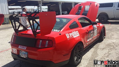

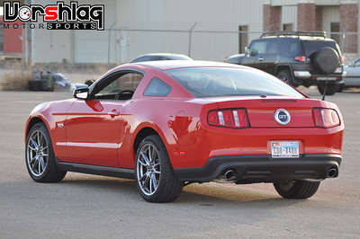

The Unsellable Mustang - Time to Part Out Big Red
The last two events only show how well this car works. We show up at a NASA event and leave with four free Hoosiers, every time for almost 3 years. We show up at a big regional SCCA event and set FTD and Top PAX, just screwing around. Easy to drive, easy to win with, and rarely do I have to turn a wrench at an event. Its a solid performer and you'd think we could sell it rather easily.
You'd be wrong. I've been trying to sell this car ever since we came back from NASA Nationals in 2013, since November of that year. Almost 18 months and we have had no serious buyers. A few flaky bidders, but no follow through. I've already slashed the price almost ten grand and we have done a lot of upgrades since 2013, and still not a call, nothing. I guess since it is not a "real race car" and its not a "perfect street car", it scares people off? It doesn't matter - I need to raise some capital for our growing business and I cannot just keep this car, so I have to do something to make it sell-able.
Instead of just dropping the price more and more, hoping to keep this car together in its current form, we're going to part it out and put it back to as close to stock as possible. It sucks but it seems to be the only way to generate any funds and sell this car. The entire front sheet metal/hood/splitter/bumper is going back to stock, and luckily I kept all of the OEM parts to do that. Wing/trunk, seats, suspension, rear axle, everything. We cannot take the steel flared rear fenders off, and removing the headers/exhaust is more work than the parts are worth used, but the rest of the mods we've done are being removed.
Some of the OEM parts going back onto this car - which is almost always the best way to recoup any costs
Roughly $40,000 in mods, custom work, and parts are being removed, photographed and added to our website for sale. I'll be lucky to get 50 cents on the dollar for some of this stuff, but so be it. After we de-mod all of the suspension, aero, interior and other bits we'll puts some 18x11" wheels on the front to match a pair of the existing 18x12" rears and put the car up for sale. This car still has a $27,000 loan value, so it should bring something with a "wide body rear" and big wheels/tires + ARH stainless full lengths and custom stainless exhaust. Will post up a link to our Clearance Page when we have the various parts removed and for sale here. Not that anyone here will buy it, but I'll post the ad for the de-modded Mustang here when it's ready as well.
Five years of hard work about to be dismantled.
This whole situation sucks. We spent 5 years building and refining a package on this car that cannot seem to lose, yet nobody wants to buy it. It pains me to see a LOT of hard work get dismantled and have to be sold off, piece by piece. Please don't PM me about any parts yet - I will post up here when they are ready for sale.
