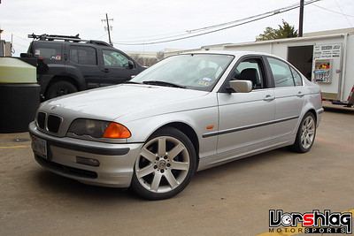

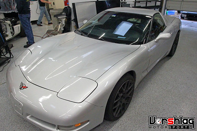

Two Corvette Builds + One BMW Build
Since we thought the Mustang was sold, we have moved onto other builds. I have apparently irked some die-hard Mustang folks after we built the C4 Corvette in January (above), but the truth is I'm just not car model or brand loyal, and never really have been. I have never kept a car as long as this Mustang before, and my need to create an all new car(s) has been growing. Vorshlag covers a lot of car markets and just as some folks don't like that we're building non-Mustangs, others are tired of seeing just Mustangs, too. Just like with our V8 swap kits - we will use whatever brand parts fit the need: the 1999 Miata LS1 kit we're building has a Mazda chassis, GM and Ford uprights and brakes, a GM V8, a Mexican built Tremec T56 Magnum, and a Ford IRS differential. Blind brand loyalty only ensures higher costs or a very limited selection of choices.
As I noted in my last post, we already selected another TT car to race this season - you can read more about Project #DANGERZONE here, but in short: its a base model 1992 Corvette 6-spd we hastily built, and I talked a decent amount of trash before its race debut. Luckily we won both days on its first race weekend, reset the TTC track record at MSR-Houston by 7 seconds, and have more left to develop (we've barely scratched the surface). Its probably going to be re-classed next year, though...

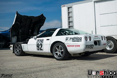

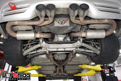

Building the cage on the 1992 Corvette this week required cutting the roof off - temporarily
For as stock as the C4 was at the January NASA event, it was still very fun to drive. We've been working on it again this past couple of weeks, with Ryan finishing the cage (above) and doing some other tweaks in time for the next NASA event at MSR-Cresson March 14-15. And to make my "Mustang treason" even worse - we're preparing Mark Council's track-oriented C5 Corvette (below) and I'm racing it at the Texas round of USCA events at the end of March. Like they say - if you can't beat em, join em! :D
Mark's 2002 Corvette is has a lot of upgrades - and we're taking it a step further this month
Last but not least, we have a brand new Vorshlag project that just kicked off this past weekend -our "Team Vorshlag" endurance BMW build, Project VorshlaggenWagen. This '99 E46 328i is going to be a race car that everyone that works at Vorshlag builds, drives and crews. We'll be covering this build on various forums (listed at this link) and running it in NASA GTS2, WRL GP2, and some other wheel to wheel classes and series.
Since these pictures were taken we have removed 435 pounds from this car - in two hours (much of the interior)

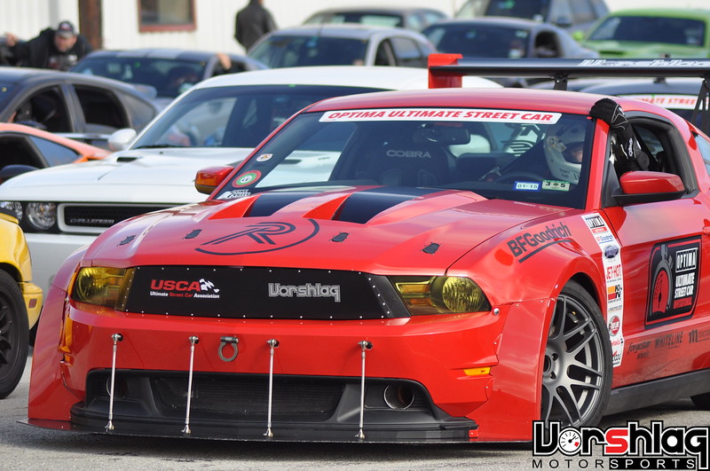

Yes, We are Running Optima Series Again + 2015 USCA Rules Changes
So I've had some time to cool off after our rather frustrating experience at the big Optima event in Vegas last November. Sure, there were some big mistakes made but they have gone to great lengths to fix them. The biggest issue I had were timing and scoring problems, but the report for many racers that ran the first 2015 USCA event at Thunderhill was very, very good. Timers worked flawlessly, they posted times after every run, and had printed times posted at the end of each day. They even had the official, final results posted online within minutes of the trophy presentation. Huge, huge improvements here and in other aspects.
I've also spoken with several folks from USCA and Optima about the Vegas issues and they took our feedback well, even when I was being an ass. They obviously have infinite patience to take my kind of feedback, heh. So I'm going to give them another shot by entering the March USCA/Optima event here in Texas. And to help them gain some exposure for the Optima series in front of a bunch of race fans, I'm going to drive our Mustang at COTA this weekend during the Pirelli World Challenge race weekend, taking VIPs around for laps on the F1 circuit between race sessions. We leave today (Thursday March 5th) for Austin and the guys are finishing the prep on the red Mustang now - should be fun!
After posting the big "roll call" picture above, of the nearly 100 entrants from the 2014 Optima Ultimate Street Car Challenge to Facebook - asking for folks to think about signing up for the Texas event, a big comment sh!tstorm started. It was only about 3 folks that got really worked up about the series rules, car requirements, and sometimes the exclusion of their personal race cars. And yes, this series is fairly unlimited but some aspects are very tightly controlled - like the tires, aero, and such.
As many of you know, defining what a "street car" is a very tricky proposition. The 2015 USCA rules changes help better define that and to exclude some radical race cars and/or aero buggies like our Mustang. And I get that. I was part of a group that created a regional autocross class in 1990 for "street tire" street driven cars and we had a total of 5 rules. It was a simple class idea that was nearly all-inclusive to all street cars, and yet fairly unlimited. When compared against the messy set of SCCA Solo classes at the time it quickly became THE most popular class in our region and often had 1/5th or more of the autocross entrants in this one class (and 25 years later - it still is the most popular class at that autocross club). Of course it got out of hand and we had to MAKE MORE RULES in upcoming years to keep purpose-built race cars from dominating.
Left: No longer USCA legal. Right: Frumpy butt version is totally legal - even with the splitter
That's what happens to ALL series that start with a simple set of rules - if they get popular, racers dream up wacky things to make an advantage, there is some general push back from the majority, and the rule book grows. It happened in NASA, it happened in ChumpCar, it happened in WRL, and it happened in the GRM Challenge. The USCA and Optima have done that as well, with the banning of tube framed kit cars a few years back (which I applauded) and with some additional rules updates in 2015 to reduce the "Raciness" of some entrants. My own Mustang had its "wings clipped" this year, and I was none too happy with that change - but I understand why it needed to happen, and in the long run I think it will be better for the series. Unless you write some very tight rules around aero (meaning: pages of rules), racers will find a way to sneak in ALL SORTS of downforce enhancing tricks.
The USCA series keeps almost everything else in check with the 200 treadwear rule - which was the same as our number one rule in our 1990 class called Super Street Modified. You can't USE a lot of horsepower without grippy tires OR without big downforce. Now they have both under control so it becomes a little more of a drivers series (well, other than AWD - which is SUPER emphasized in their standing start events like Speed Stop and Autocross, but don't get me started on that).

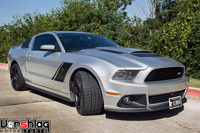

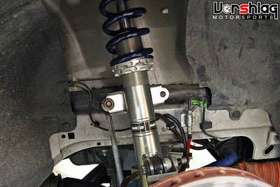

If you watched that video above, one of the recent S197s upgraded here is James Meeker's 2014 Roush Stage 3 Mustang. This car already had an Ford Aluminunator (forged internal) 5.0L crate motor and big supercharger, but after he got the HPDE bug he found Vorshlag last year and we have done a lot of upgrades to it beyond what Roush installs.
James both daily drives and tracks this car all over Texas. His first "want" was more grip, so one of the first things we did to it was a wheel/tire upgrade + our Bilstein StreetPro suspension. The 18x11" Forgestar CF5 wheels are wrapped in the "big" 295/35/18 BFG Rivals, and they fit well under stock fenders.

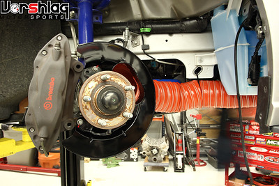

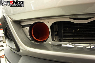

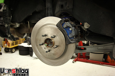

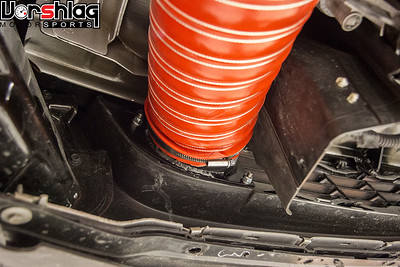

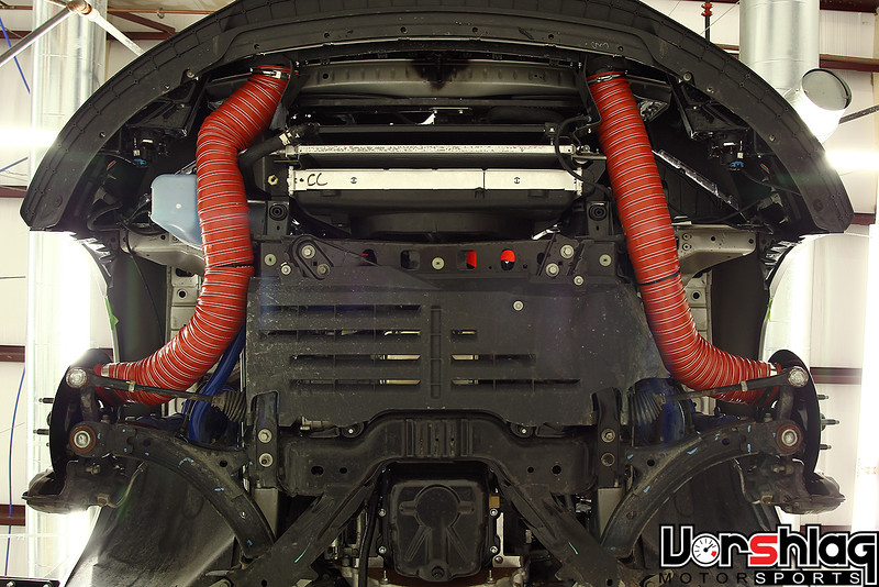

The brakes have been upgraded to slow this big car down, with our GT500 14" rear rotor upgrade, Carbotech pads at both ends, our 4" oval ducted front backing plates, and custom 4" front inlets hidden behind the Roush lower grill.
It is explained better in the video above, but basically we made something like our 3" dia front inlets ducts for the '13-14 GT/GT500, but customized them for the Roush grill as well as to be 4" in diameter.
It is a tricky routing on this car, which has an intercooler, radiator and pump in the way as well as routing of oil lines for the massive oil cooler we added.The windshield washer bottle also makes routing of these big 4" brake hoses tricky, but it works and brake temps dropped dramatically.

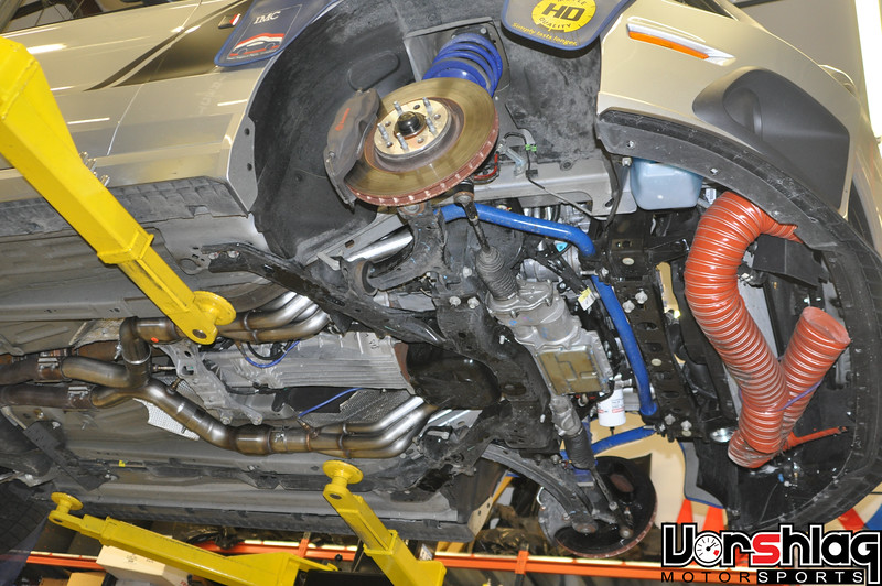

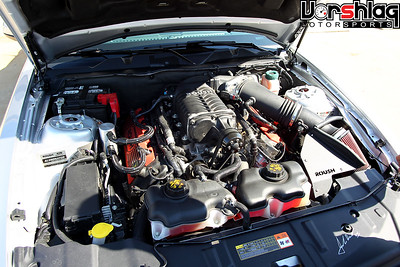

Next, as with most Mustang owners, he wanted more power. While its the last thing this car needed, I really can't blame him. Horsepower is addictive. As usual, the header install isn't fun but it was knocked out in a day and the ARH catted X-pipe was tied into the OEM center section and the Roush rear exhaust. It was loud before but now IT WAS LOUD!
A supercharged engine will always run hotter than the NA versions on track, but we've done a great deal to keep heat in check - and we're still improving it. First up, we had the guys at Trust Street tune the motor after we added the headers to be "road course safe", avoiding any lean conditions at all times.

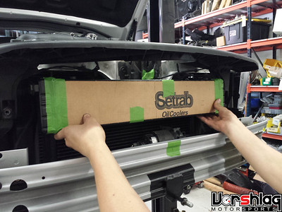

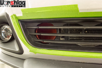

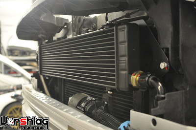

Next, we ditched the Boss302/Track Pack "oil heater" set-up and added a massive Setrab air-to-oil cooler to make a stack of heat exchangers four thick (engine radiator + intercooler + air con condenser + oil cooler), and that helped quite a bit. After his next track day he is coming back for the Mishimoto radiator upgrade as well as a Seibon carbon hood which is vented - and we will duct and vent further. I'll show that in another post.

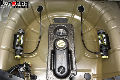

It wasn't long before James decided to embrace track days and he outgrew the Bilsteins and lowering springs, so he took the plunge this winter to go to MCS RR2 double adjustables with remotes. We kept the spring rates on the soft side since he still drives it on the street and to track events across Texas, and the ride is surprisingly good. The remote reservoirs are all mounted on custom brackets we fabbed up and have cushioned clamps holding them down, with the rears passing through 2-piece "Seals-It" grommets for a weather tight trunk.
We also added Whiteline "everything" during the MCS install, with their Watts Link kit, LCAs, LCA brackets, and swaybars + end links at both ends. This set-up kept the Vorshlag camber plates from the StreetPro suspension, which has since gone onto his son's 2014 GT, and now we have the suspension pretty well sorted.

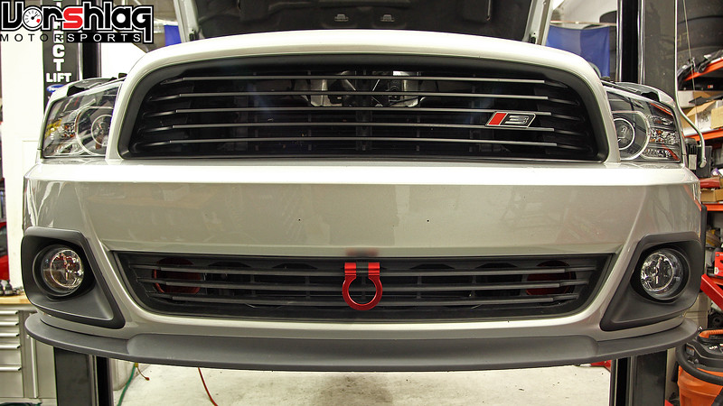

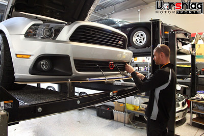

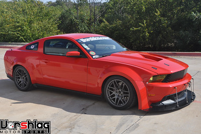

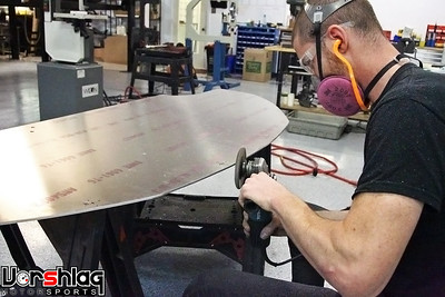

I showed pictures of the custom front splitter we built for this car in my last update. It's a stout, 6061-T6 aluminum plate unit like on my own car, but this time made to fit up against the Roush lower valance or "air dam" section. It was all hand built - carefully laid out on a template then transferred to aluminum and fitted to the car. No fancy high tech CNC anything here - just skill, time and a steady hand.
The black plastic Roush lower valance bit is flat on the bottom (necessary for a splitter) but unlike the '13-14 Boss302 lower valance, this one is fairly affordable and a bit longer front to back. We'll start using this Roush lower valance on '13-14 GTs that need a splitter from now on.
The bracket for splitter struts is hidden behind the Roush lower grill; it was tricky to make but required no big holes in painted bodywork (unlike my car). Very tidy.

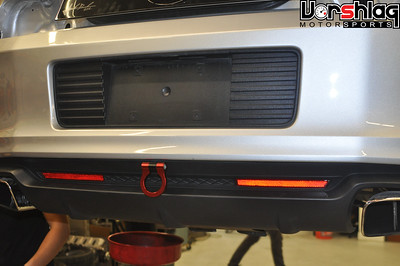

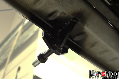

Tow hooks are a good idea for any track car, but the bolt-on kits I've seen offered for the Mustangs are a bit kludgey and heavy. Likewise, the Ford Racing weld-in kits are a bit simple and require cutting holes in the painted bodywork to mount them. We've done several custom front and rear tow hooks on S197s and managed to make them work without cutting holes in painted bumper covers. We place them so they mount right to the bumper structure. In the rear we can just drill a hole in the black plastic rear lower valance piece (replaceable) to have it pass through the body. Likewise on the front, the tow hook mount is cantilevered off the front bumper and passes through the lower grill.

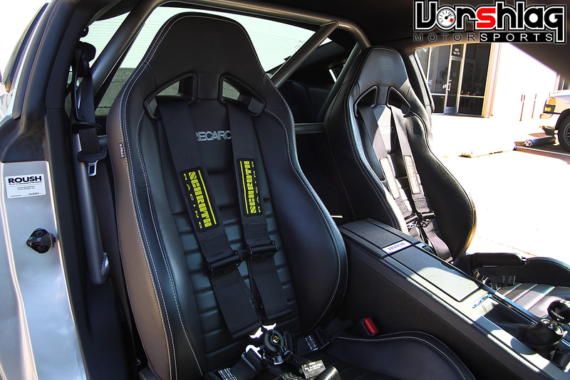

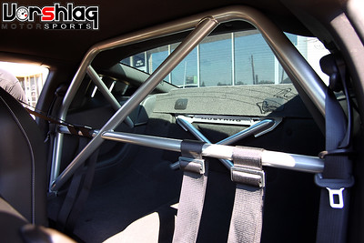

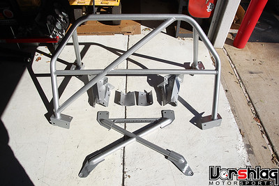

Other safety aspects include the addition of a roll bar and harnesses. For the 4-point roll bar kit we always go to Maximum Motorsports, who makes the best kit for an S197 by far. These kits come in pieces and have to be fitted and tack welded together in the car, then removed and fully welded. We always order them with the optional diagonal and harness bars. We removed James' rear seats and installed the Laguna Seca X-brace and seat delete kit at the same time, which we had bead blasted and all powder coated the same metallic silver as the body.
Schroth 3" cam-lock 6-point harnesses round out the safety gear. We have the lower anti-sub belts custom made to work with the factory Recaro seats (which don't have openings in the seat bottom) and it works like a champ. We made special brackets to add anchors for the lap belts and anti-sub belts also.

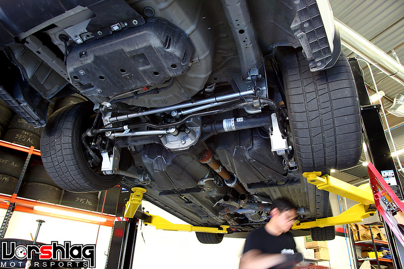

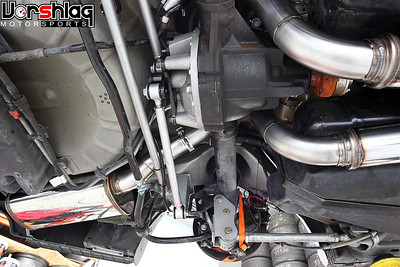

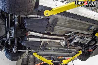

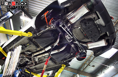

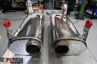

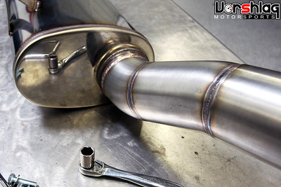

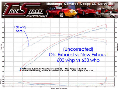

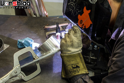

The custom exhaust we built was a good bit of fab work and I could devote a whole post to that, but here are the highlights.

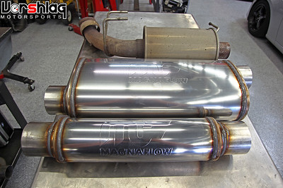

If ever there was a Mustang that needed dual exhaust, it was this car! It was already making 600 whp with the 1-7/8" ARH long tubes and the blower, but it seemed a bit choked to me and it was crazy loud. A lot of what eliminates sound on a car is the shear size and interior volume of the muffler case. The Roush mufflers are itty bitty and only a 2.5" inlet/outlet. The rearmost MagnaFlow mufflers we added are huge in comparison, which you can see above, and have a 3" inlet and outlet. They flow more exhaust while eliminating more noise.

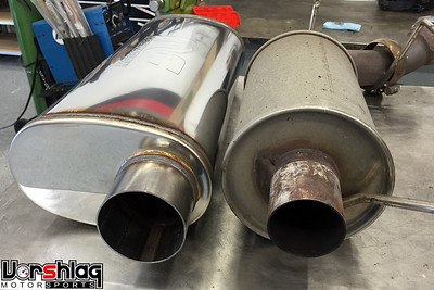

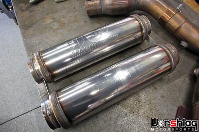

We added bigger 3" resonators ahead of the axle as well, to replace the squashed OEM resonators that Roush equipped this car with (the entire rest of the exhaust other than just the mufflers + tips was stock when it shipped from Roush).
The X-pipe had to be modified to get the most room for the 3" V-band clamps we added. After the X-pipe was tweaked and the 4 muflers mocked into place, then the 3" mandrel bends were spliced together to make the best routing for chassis and car clearance. The rear exhaust was tricky and was built with the axle tied up at "full bump", with the springs removed. We do this to ensure clearance when the rear suspension goes through its full range of travel.
It was a tricky bit of work but in the end it was worth it. The sound levels are MUCH lower yet the car picked up 33 whp with the new exhaust.

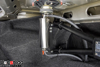

We also made a rear axle catch can system, which is plumbed from the top of the Whiteline rear cover and the "Vent" is vented outside of the trunk, through a small air filter. Keeps the fluid where you want and the smells out of your trunk.

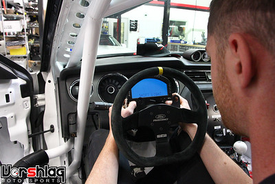

Jamie's ST3 Build

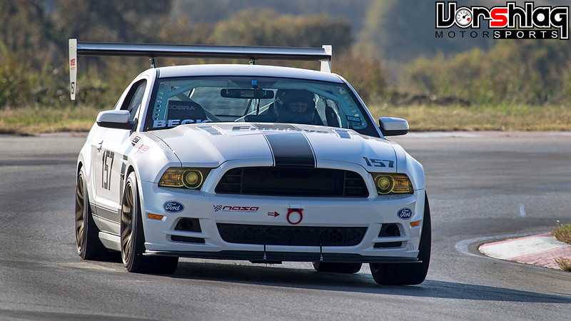

Jamie Beck has been having a lot of fun on track in his 2013 GT that we modified last year for ST3/TT3. Recently it was in for a false floor and a digital dash install.

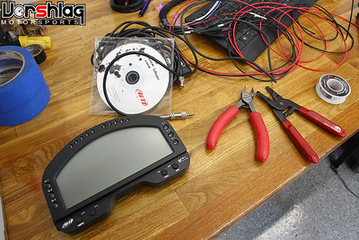

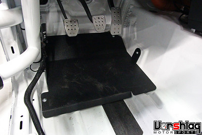

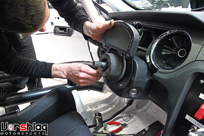

We're an AiM dealer and Ryan has installed these in race cars before. What we installed on Jamie's car was an older AiM Pixa unit that he picked up second hand. These are CAN bus driven and it wasn't all that difficult to install and wire up. It was about 3 hours for mounting, wiring and programming to get it to talk to the Ford ECM - and now any OBD/CAN channel can be displayed on the dash, with multiple programmable and selectable screens. Works like a charm and is has a built in GPS transponder so lap times and predictive timing are all in the same unit. It data logs as well.

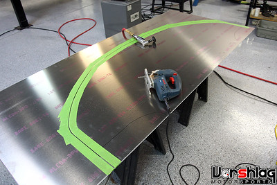

The false floor was a pre-made unit that we modified to fit around the roll cage. It provides a flat floor surface above the oddly shaped stamped floor pans, with an air gap to the floor. If the floor ever gets hot from the nearby exhaust header the air gap to this false floor keeps that heat away from your feet.

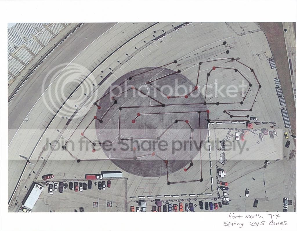

I can't tell where the start is?
In the words of Sir Charles, that's turrible.

In case you wanted to see what you are up against for GG.
Yes, that's what Goodguys autox looks like pretty much everywhere. I've run Goodguys at TMS 3 times in the past 2 years (they come every March and October) and it was always tight like this. Here's some in-car video (which is posted earlier in this thread) from my last time to win their All American Sunday autox at TMS, October 5th, 2014:
Is it tight? You bet! Is it painfully tight? Maybe, to some... I also used to complain about the Goodguys autocross courses, but they are consistent and they PAY OUT WELL. Its more like a gymkhana event than an SCCA style autocross, and almost always includes lots of 1st gear bits. There is often some part of the course you drive over twice (there were at both 2013 TMS events), and the number of runs you get on the All American Sunday varies - most events I made 3 runs, the last one I got 5. Most folks don't even bother to walk the course and you don't even need to wear a helmet - its such a different type of event.

is the oil cooler that you put on the Roush car available through your shop?
