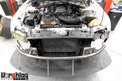

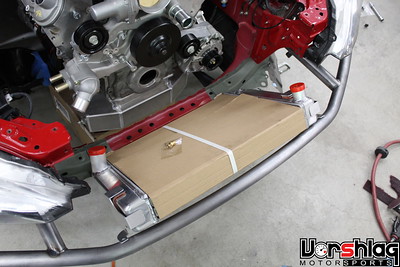

Yes we have made a number of one-off, full width, tubular bumper beams that are both curved and bent to fit.
There is a lot of custom fiddling to make these fit correctly, mount the bumper cover to, etc. As Jason mentioned we do this to be able to make custom splitter mounts, oil cooler, mounts, make more room for rolled radiators, etc.
We have had a number of requests to replicate these for the S197 and I have been slowly staffing up to be able to tackle turning these fab-intensive one-off jobs like this into production versions. The S197 is likely the first one we will replicate, then the S550, then go back and attack ones like the BMW E46, 86, and some others.
We've had some of our customer cars crash into other cars with these wider bumper beams and they fared much better than the cars with narrow versions or stock bumper beams. There are good reasons to do this....

That was my next question, and that kind of makes me want one. What's the weight compared to stock? Any idea?

The extra room for mega sized intercoolers looks enticing. The possibilities of the extra space between the radiator and the engine would be so nice for us turbo guys as well.
Agreed.
With heat exchangers for the S197 getting bigger and better (ala DOB Titantic and Super Single), it would be good to be able to open the bumper up a little. That obviously means plastic/fiberglass fabrication in addition to the bumper bar, but there is potential for a badass look and functionality. Imagine that lower grill area on the S197 being made taller and revealing more of a good looking HE.
