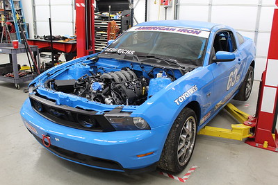

I'm not arguing for LS swaps, just have to always put that out there as a warning. Now we have a customer that asked us to upgrade his 2010 GT which had the lackluster 4.6L 3V engine. 300-315 hp, makes 260-280 whp in NA form with some headers, CAI and tune. Wee!
He wants to move out of the class he was in (NASA Spec Iron) to a class that allows +100 whp (American Iron). Our suggestion was to over shoot the ~370 whp the class allows and go for a Gen 2 Coyote swap, make 450 whp, then use the electronic throttle to restrict the tune to make a "flat power" 370 whp across the board. Old trick, really works. Uncork it for fun events and let it fly!

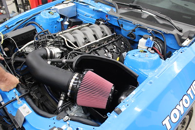

He went with a Tremec T56 Magnum XL, ARH long tubes, Gen 2 crate motor, and the Ford controls pack.
We have found a lot of part numbers for Gen2 specific parts we need, made a lot of little brackets and doo-dads to make the Controls Pack bits fit, and have the swap mostly done. I will post more here as work progresses. We currently are looking for these solutions:
1. Making the stock gauges work (doubtful - will likely use AiM digital dash)
2. Get some ideas on making a 2011-14 EPAS electric rack (Boss302R rack) working
The wiring and CAN comms are always the hardest part of any swap, and this looks no different. Except that there seems to be only ONE source for a wiring harness to work with the OEM computer (Ford). And there seems to be no way to make one street legal (which is what about half of our LS swaps end up doing).
