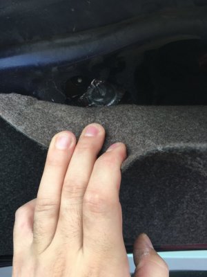

  9. Sky Render
    Sky Render Stig's Retarded Cousin S197 Team Member
    9,280
    246
    Which ones? Can you post a picture?

  11. kona302
    kona302 forum member
    161
    Sure, ill post a picture of it later. If you open the trunk, and on the trunk lid you remove the carpeted cover you see bare metal, it was clear to me because of some light rust and water residue. I covered it with some AC duct tape and haven't had any more water enter into the trunk since.

  13. nbk13nw
    nbk13nw forum member
    338
    24
    Is that where the bolts for the spoiler comes thru the trunk lid?
