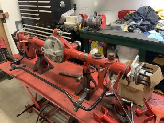

Want to weld my housing to my differential and am getting conflicting info on whether the housing is cast steel or iron. Any advice on how others do it?
