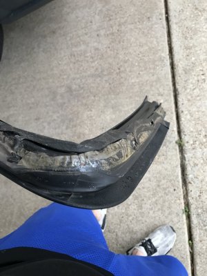

Figured it out. I saw water coming in from the upper seal I’m assuming both are bad so yay there’s $150 in seals

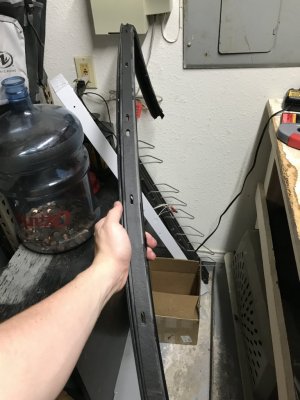

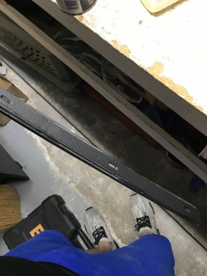

85E9FA96-46AB-4C97-A46C-ABA63248F008.jpeg 59765516-BE64-42BF-BE7B-9BC51FC81212.jpeg E04798FD-768E-4DC3-A61E-7B8D6A89E056.jpeg 49B1C608-6BE8-43EC-9459-79FC0881A025.jpeg Thanks everyone for the help. Parts came in today and man no wonder my floors were wet.
