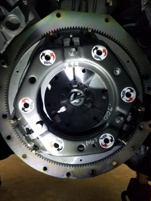

Got the Magnum installed this weekend! The separate bellhousing made everything a breeze compared to the 3650. Had to machine a sleeve to make the clutch alignment tool worth a damn, but it was worth it to get everything aligned.
Went with a sintered iron slipper clutch from Black Magic. Still getting it dialed in for street driving, but it should help launch the car at the drag strip immensely.
1st through 4th are faceplated, it's definitely taking some getting used to! It's hilarious to me how obnoxiously loud it is when shifting, but I'm sure I'll get the hang of it. Everybody said you just gotta jam it in gear, and now I really know what they meant! Going to break it in some before I really give it hell, but the few high rpm shifts I've done are as smooth as it gets. No resistance whatsoever, the shifter will move as fast as you can snatch it!

That seems like a very aggressive clutch for street use. How do you make adjustments with the bell house in place?
We cut an access hole in the bellhousing to adjust the base pressure and change counterweights. 'Technically' this is supposed to be performed by company that makes the bellhousing, but I also don't see a tech inspector jacking the car up to take a look.
I heard from a few Drag Week guys that had run these clutches, racing and pulling a trailer all week. I wasn't getting anywhere with an RXT at the track, even tried a Clutch Tamer. It definitely has taken some extra consideration on the street, but hasn't been something I regret at this point. Need to make some adjustments for street driving this weekend, but I don't see why it can't be dialed in fairly well.
Small consolation, it's a single disc clutch and has the lightest pedal feel of ANY manual car I've driven by a mile.
