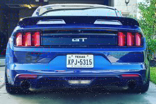

Did a thing a few weeks ago and grabbed a GT350/GT500 "swing".
Finally got around to mounting it.
And...I love it. Now I just need to find a way to fashion a gurney flap/wicker bill as I'm not paying $600 for the Anderson Composites one.

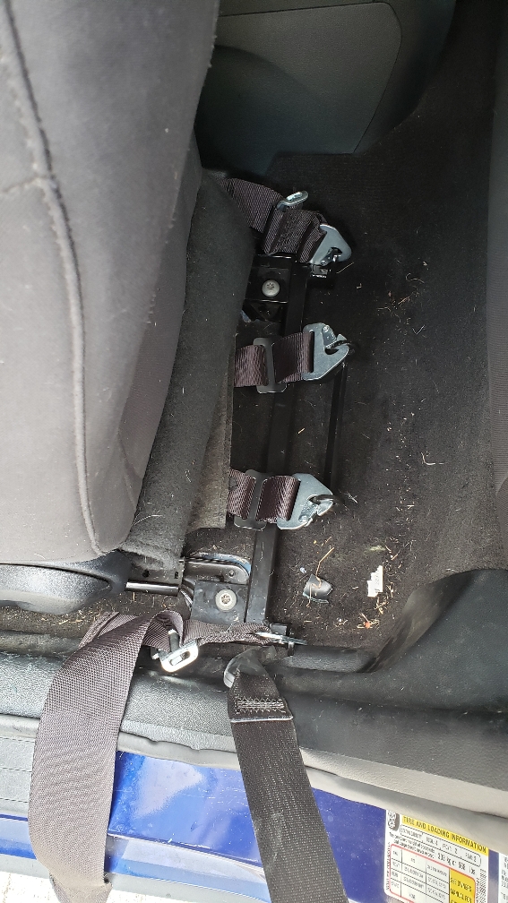

Installed the bracket to allow me to use 6 point harness with stock seats. Now I can be securely fastened in my seat after I drive multiple hours to an autocross event.
My race seat was just too darned uncomfortable for long drives.

What harnesses did you go with? Are they DOT approved? It appears that you are retaining the OE belts, when you street drive, do you only use the OE belts? Thanks

I still have the 3 point for street driving. The harness is not DOT approved, but it is FIA rated racing 6 point.
This was a better option for me since I already had the 6 point for my racing bucket. I have a quick fit harness that I bought before this bracket, but I'll be selling it as this setup fits my needs especially since my rollbar is still installed.

/\ interested as well.
I believe the only DOT approved harness out there is made by Scroth. It is DOT approved because it uses factory mounting points and stock retractor/locking mechanisms. I think it's only a 4 pt harness too. I have one I never installed, I'll have to take a look at it.

You are correct. Schroth quick fit and QF Pro

For the S197 Corbeau also makes a 4 point harness and harness bar, I have both in my 2010 with my Roush seats. Their 4 point uses the factory locations as well. The harness bar is a little bit of a job to put in and reduces access to the back seat, but allows proper angle for the harness over the shoulders. It also adds stiffness to the car. I still have the factory harness and use both on the track so my seat belt alarm doesn't ding. I put the 4 points on first, then pull the factory over the top.
