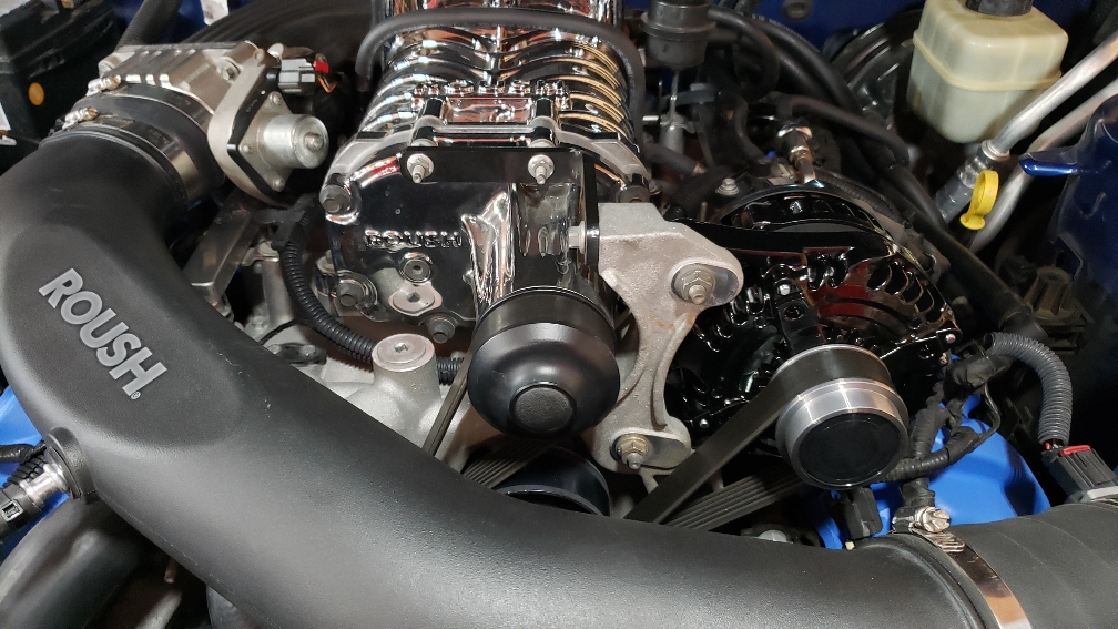

New DOB alternator

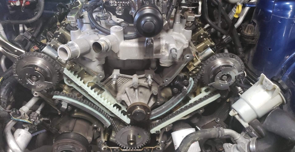

Did a full timing job.
