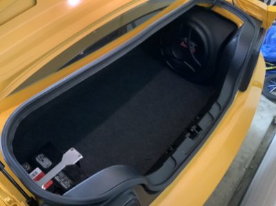

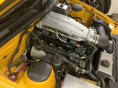

Just finished relocating my battery to the trunk.
I used the original battery tray (heavily modified with bench grinder lol) and hold down, (along with a billet dress up hold down I already had). Used all the original terminal cables, and made my own distributor post for everything to connect to under the hood. The only thing I purchased for this mod is a 25’ 1 gauge red cable on Amazon. Only trick was making a really good ground connection in the trunk. Works great!

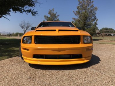

Just before that installed a prepainted Cervini’s ram air hood.
