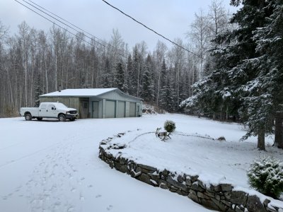

Began the winter tare down, inspection today. Have a clutch problem to diagnose and repair. Ordered a roll bar a week ago that’s 6 weeks out and I’m thinking about stepping up a little higher in cams. Valve covers and timing cover are coming off for inspection anyway. I have a Ford Racing timing set to freshen up the front of the engine and will use a steel crank sprocket. Time for a SFI damper as well.

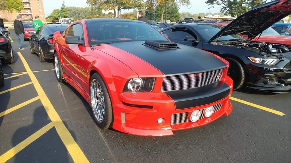

Ferrada wheels? Great fitment. What specs did you have to go with?
