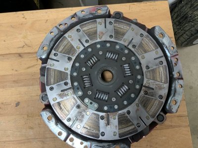

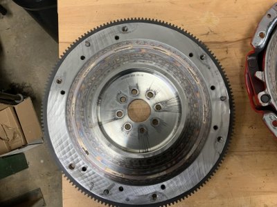

I got the clutch pulled out of my GT today. As expected, with some relief, the clutch disk had welded itself to the flywheel. All 10 pucks transferred material to the flywheel.

That is a McLeod steel flywheel with their Extreme Street clutch and pressure plate. Supposed to handle 700 hp/tq and work on the strip. I had no complaints, never felt it slip and it grabbed smoothly. Until it stuck. I talked to McLeod and they said I overheated it. OK, I explained it was the first run of the day. Four second burnout in water then roll out under power to clean the tires. Eased up to stage all normal and launched at about 5 grand. It wrinkled the tires and lifted the front wheels and sadly would not shift. McLeod suggested not powering out of the water box. I said “what?
I am thinking the RXT is next. I took the flywheel to a machine shop to be resurfaced.

When I got a clutch recommendation from McLeod a few years ago they insisted on the RXT as soon as I mentioned the dragstrip, even with only 600 hp. Never had any slipping issues while it was in the car.

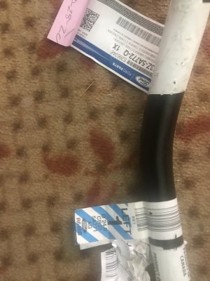

Have replaced my existing OEM front sway bar w\ this FoMoCo part# BR33-5482-BE ('13 Ford Mustang Boss 302) which is a part used w\ the Ford Performance Pack option also provided for same MY GT Coupes if ordered so. Tested the part on some twisty roads after install (in tandem w\ recently installed Ford Performance M-3075-E FLCA Kit w\ prior installed Ford Performance M-18183-C USM Kit using Koni STR.ST struts\shocks w\ the OEM '09 frt\rear springs) & the handling performance\steering response was so night & day improved over the OEM part it replaced, I went to my local Ford dealership today & had this frt sway bar's part# cross referenced to find the matching rear sway bar assembly for the same '13 Boss 302 (part# CR3Z-5A772-Q....comes fully assembled w\ all parts to install it out the box) & ordered it to replace the existing OEM rear sway bar assembly on my '09 Stang as well to work in concert w\ the new frt sway bar.
I like that these parts provide a useful upgrade improvement path for 05-09 S197's while still maintaining OEM look\fit.

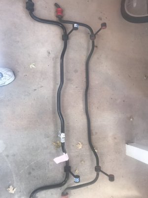

It's done!
Not even close....new bar's center section also resides further up under car giving a lot more clearance for floor jack access.
Tested all out & now the car is much better balanced & controllable which inspires more confidence rolling into\powering out of tighter turns at higher speeds w\ this upgraded OEM PP frt\rear sway bar tandem (makes better use of these Continental Extreme Contact DWS06's I have her shod with). Becoming more fun to drive now................

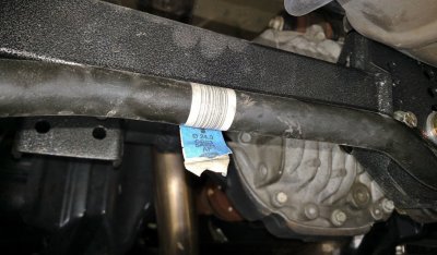

What is the thickness of the new bar? 24mm ?
Also, Any chance it has a sticker like this on it, with this exact part number?

Yep it's a 24mm dia bar. CR33-5A771-AG is the actual Ford manuf rear sway bar tag part# (also references mounting position on car) that was referenced (the FoMoCo CR3Z-5A772-Q) to this BR33-5482-BE actual Ford manuf front sway bar tag part# I bought used\low miles (looks brand new) that physically came off a '13 Boss 302.

Ok. The picture I posted is off my car, a '13 GT Track Pack, also with a 24mm rear sway bar. I'm thinking it's probably identical to the one you just bought, the one you got maybe just an updated part number. Ford is known for doing that when they make a change, however slight it might be.
