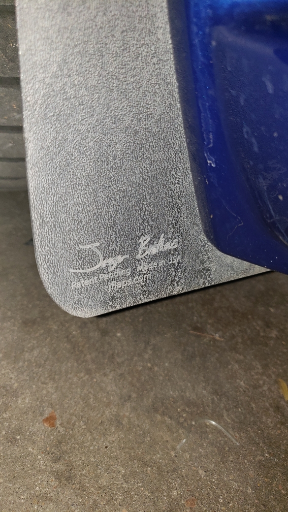

Just noticed you have the 2007-09 GT500 wheels in 18x9.5" and was curious as to what size your 18" tires are both front and rear? Also curious what brand your splash guards are as well, as I'd be interested in getting a set for my "06" GT. Meanwhile, thanks for sharing an image of your S197 GT :waytogo:

275 40 18's all the way around. The mud guards were on it when I bought it. I'll look for any identification on them next time I'm in the garage.

I also have 275/40/18's on all 4 corners as well.. Firestone Firehawk Indy 500's on the same GT500 wheels as yours. Meanwhile, look forward to the identification info on the splash guards the next time your in the garage :cheersman:

I also have the Jeager bros on mine as well. Unfortunately one on the rear somehow managed to come off, so I don't know if they can sell just a single replacement or if they're only sold in entire pairs/sets? I'd also be interested in getting molded splash guards, if any are available for both front and rear :shrug:

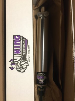

Put on some Kelltrac (Kelly Aiken) valved Viking crusaders. Looking forward to getting out to do some testing. As far as I know, the only 6r80 (not 4r200) cars in the 7’s all wear these setups. Correct me if I’m wrong
