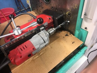

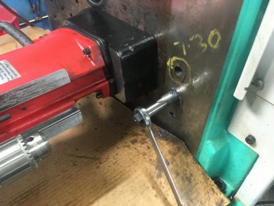

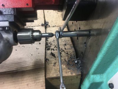

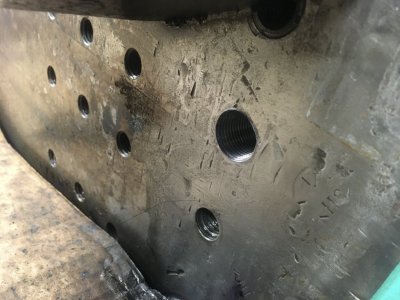

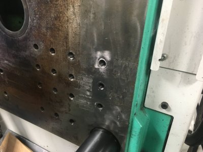

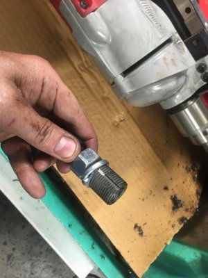

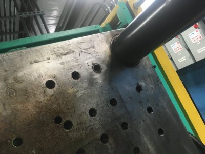

There are other thread-insert types as well, used for different applications.
Here I repaired pulled-threads (5/8”) in the face of an Arburg 165-ton molding-machine platen. The inserts are made from a tool steel. Nearly file-hard.

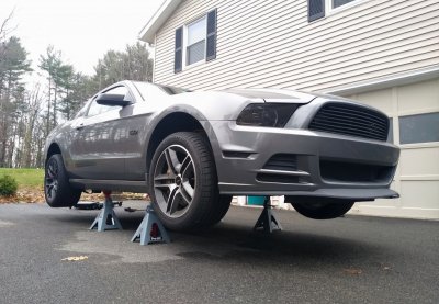

Jacked it up and had the wife inside giving it gas, as I was trying to pinpoint the source of a rattle from underneath. Pretty sure it's in the h-pipe at this point, either a crack or a broken weld.
I plan on removing it to further inspect it. We'll see, I have the factory one I can throw on if needed.

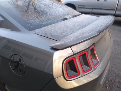

31 degrees outside and I'm taking this to work :)

Time to put the chains on :D. Like the decal on the gas door BTW.

I had busted cats on 2 different occasions that rattled like crazy. I swore it was metal on metal rubbing somewhere on the exhaust.

I chased down a rattle that turned out to be the heat shields. At certain speeds/RPM's, the heat shields would vibrate and send rattling sounds back into the cabin. I thought for sure it was metal on metal but it was just the shields. Lightly giving them more of a bend here and there stopped the rattles.
