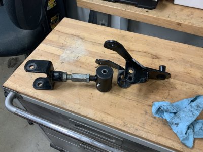

Inspecting and making adjustments to the rear suspension. Removed the upper control arm and mount. I have been using the lower hole in the mount and will try the upper hole to see if there is a difference in performance. Once apart I discovered the urethane bushing is broken. If memory serves this unit is BMR so I can simply replace the bushed end. Also installed a Steeda spherical bushing in the diff. while it is easy to reach. I see marks on the diff. bearing mount where the control arm has been making contact. That can’t be good. I hope the spherical bushing stops that.

Contact mark on the diff.
If I'm reading that picture correctly - the line on the UCA's axle-side pedestal, you had three geometry-related things all conspiring to allow it to happen.
Lowering
Use of the lower hole on the chassis-side bracket
The poly bushing deterioration
Lowering and the lower hole probably wasn't enough without the bushing issue, which was probably allowing enough extra axle wind-up.
Were you getting any wheel hop?
And on edit, polyurethane bushings, especially rear control arm bushings, need to be considered "wear items", particularly under conditions of harsh performance use.
I think you nailed it. I have another non-adjustable, same brand upper arm to salvage the poly bushing from. It’s back together now and using the upper mounting hole. Never thought I had wheel hop. Looking at video of my launches on slicks i can see the tires get hit. I have seen the tires rebound. I have seen the tires wrinkle and felt some shake, I think. Maybe that was the bushing failing. I have seen the rear suspension rise and unload but I have never seen it jackhammer. Video is such an awesome tool.
