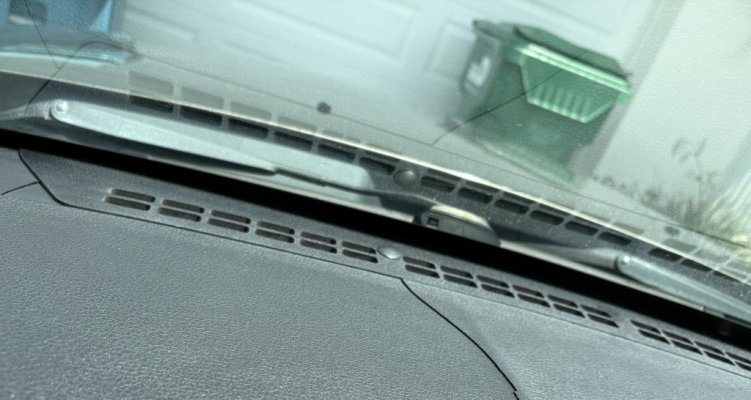

Got tired of liking at the broken dashboard defrost vents and ordered a kit from eBay.
It’s not perfect but better than looking at a hole with broken grates. Now need to figure out how to cover the dash cracks?

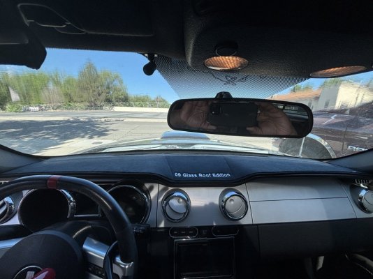

I ordered a custom dash cover from Covercraft to do to my dash for the same reason as to what you're wanting to do.
Thought I already had a picture snapped of it, but I don't.............will get 1 coming.

Posted picture of my dash cover from Covercraft in prior posting...............this cover will actually cover any dash vent replacement piece I install so won't look out of place. This cover is Covercraft's DashSuede design.........do make a carpet design to match the interior carpet.......attaches to dash using Velcro & has UV treatment to supposedly keep underneath dash from getting further destroyed..............haven't checked to see if this is true.........kinda don't care as the damage has already been done, so as long as the cover holds up I'm good.

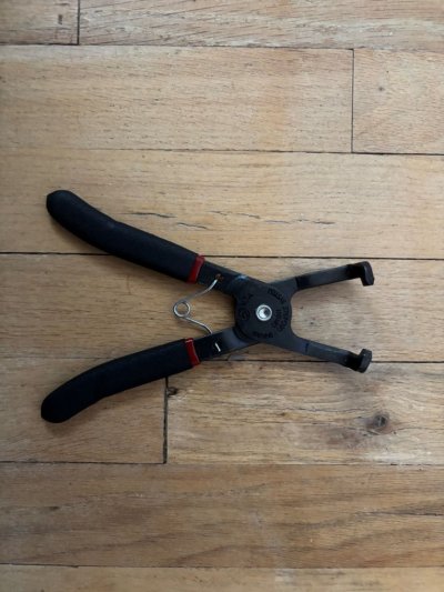

Provided below is a tool that can save you a LOT of grief when replacing the connectors located at the heater core\firewall................Lisle 37160 85* Multi-Purpose Disconnect Pliers (bought thru Amazon but can be found in some auto parts stores in their tool sections.........if stocked that is......). I bought these after this work was finished to ensure going forward that I had the right tool to easily deal w\ these heater hose connector latches against the firewall & other connectors as well (double button connectors......used on some vehicle fuel rails, fuel filters & PCV systems as well as some electrical connectors, etc...........). Lisle makes a 45* version of this tool (37140) if also desired........I'll probably pick this 1 up as well sometime later on...........
When you start having to suffer w\ carpal tunnel in both wrists like I have from yrs of repetitive motion stress in both hands, these tools start looking good to have.........that is if you plan on doing as much of your own DIY maintenance\repairs as long as you can physically do it..........which I certainly plan on doing.

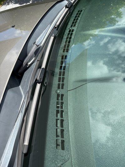

Guilty as charged. My issue was the defrost "vent" had cracked, but only enough to rattle...annoyingly. i actually used hemostats to remove all the fins and the metal one (using vct) perfectly covered the, now gaping, opening. About as good as I could have imagined.

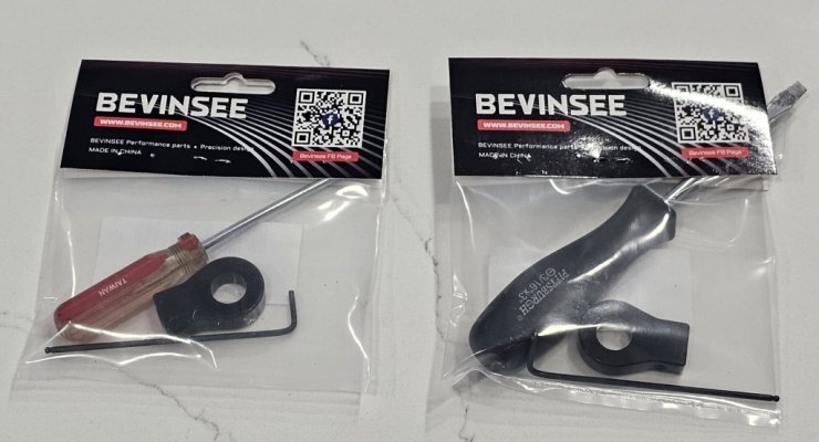

I put together 2 emergency repair kits for our Mustangs for the clutch master cylinder rod eyelet that is known to break, rendering the car undrivable usually.
This kit would allow me to remove the broken plastic piece, install the aluminum replacement piece held in place with a set screw, and drive away.
These are now in the glove boxes, "just in case".

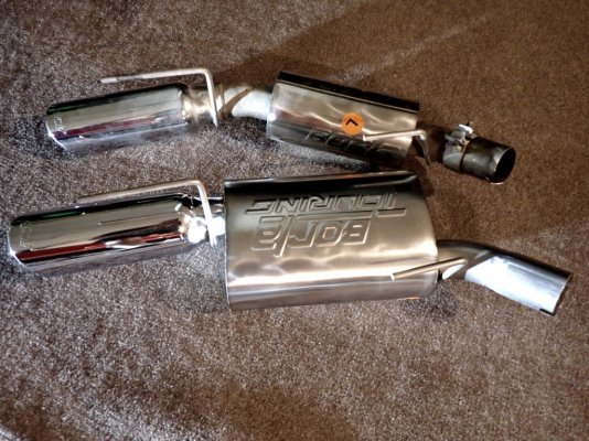

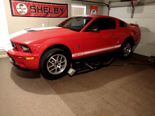

I swapped out the Borla Stingers for the Borla Touring. And went over the entire exhaust tightening up all the clamps. The pic of the quickjack was at the lower setting when I took the pic. I raised it to the max height when I went over the entire system.
How do you like them? Mine are nice and quiet at 60mph but the resonance at idle was HORRIBLE with my long tubes. I had some resonators put in which helped but it wasn't till I got the centri that it finally got better. Still pretty bassy at idle but not nearly as bad as it was.

I am not sure. I haven't even taken it out yet with all the foul weather here. I don't drive this car in the rain. I am sure they will tone down the exhaust some but I know I still have more work to do to make it suit my tolerance. My warm idle was actually tolerable even with the Stingers but once I got to 1500RPM+ the groan was a bit obnoxious. If these help that mid range rpm drone some, than I will be happy. We shall see. I am expecting an improvement but nothing perfect. Once I see how it performs, I will make more adjustments if necessary.

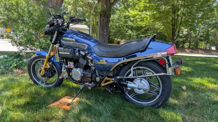

Not mine, a buddy's but still let me drive it
This one *is* mine and carbs and loose wiring has been taking up most of my time

My HS days motorcycles were Z1R, Ninja, Interceptors and Vmax… but I had a 1980 Pontiac Trans Am. lol

Lol, It's a 1982 so right in that era. Just slightly older than me, but was my dad's so had it around since 1st grade. Great bike to ride, V4 powerband is fat from 3500 all the way to 10k RPM and really easy handling
